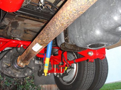

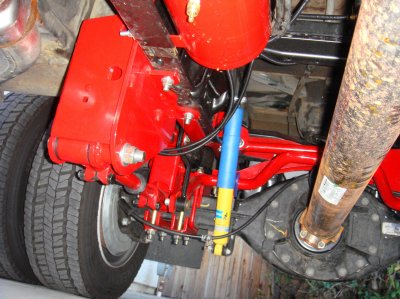

I just picked up my Rig from Valley Truck Accessories (Dentonis) in Stockton, California. WHAT A DIFFERENCE...! I had the Front (2 bags) and Rear (4 bags) 4 link with Auto height w/ dual rear dump valves installed. The system allows for stock height but I think they gave me a couple of inches lower at my request. the Dump (kneel) operation allows another 3-4 inch drop which makes it so much easier to work off the back of my Weld Rig. All the control switches needed were hooked up to my upfit switches and the (low pressure) light was thoughtfully placed to provide a clean installation. The ride is so smooth and controlled it feels like I just added 4 inches of foam it my seats. Valley Truck set the (supplied) Rancho front shocks on 7 and I agree. I had Valley install Bilstein's on the rear (the system doesn't come with rear shocks). Considering I put 105k miles on my 2006 3500 Silverado C.C. (Duramax) which was 3000 lbs. over weight but rode like my Denali, I am finely happy with my 2015 F-450 Lariat SC, CC 84" CA work Rig. Kudos to Kelderman (Mark Stek) and Aaron @ Valley Truck. If the $$ won't kill you but the ride is... GET ONE.. it's AWESOME..
