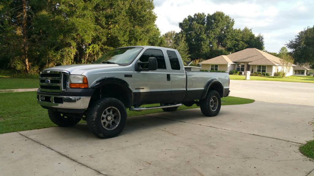

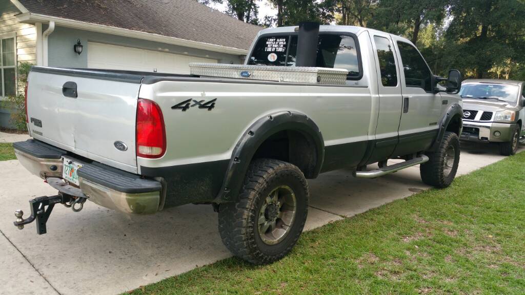

If it were me I would do the cross rail repairs first. Keep the foundation solid. Then I would keep eyes open for the doors of the same color as you find them. Get one here, one there until you have what you need. Should be direct bolt on, no painting and less money. Then do cab corners when you can or do them before the doors since those might affect cab integrity. If you really like your truck and it fits your needs then at least you know what you have. Your rig looks rally nice in the pictures. Getting it back in top shape doesn't appear too bad from what we can see. I realize pictures don't always show the details. Glad you passed on the OBS. Sounds like a bigger headache than what you have. On a 6.0 if the EGR is deleted and no tuner has been used then headstuds aren't really necessary. Tuners without headstuds seems to be the problem as long as the EGR and oil cooler are working properly or the EGR is gone. When I have the money EGR delete and a 4" exhaust are my only future mods. Then monitor the motor and drive.
