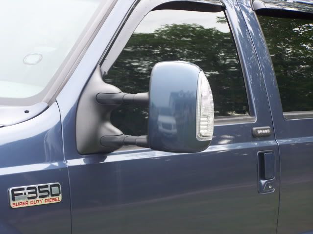

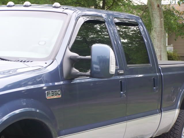

I used a real fine sandpaper (like a watersand paper) to knock off the shiney of the chrome.
After sanding, I used acetone to clean them up (takes off oils/wax)
I sprayed no telling how many coats of base & clear. I will probably redo them before long. The clear I used is just not shiney enough, and I don't think I let them dry long enough. The next day, you could see where all the bugs have indented into the paint.
