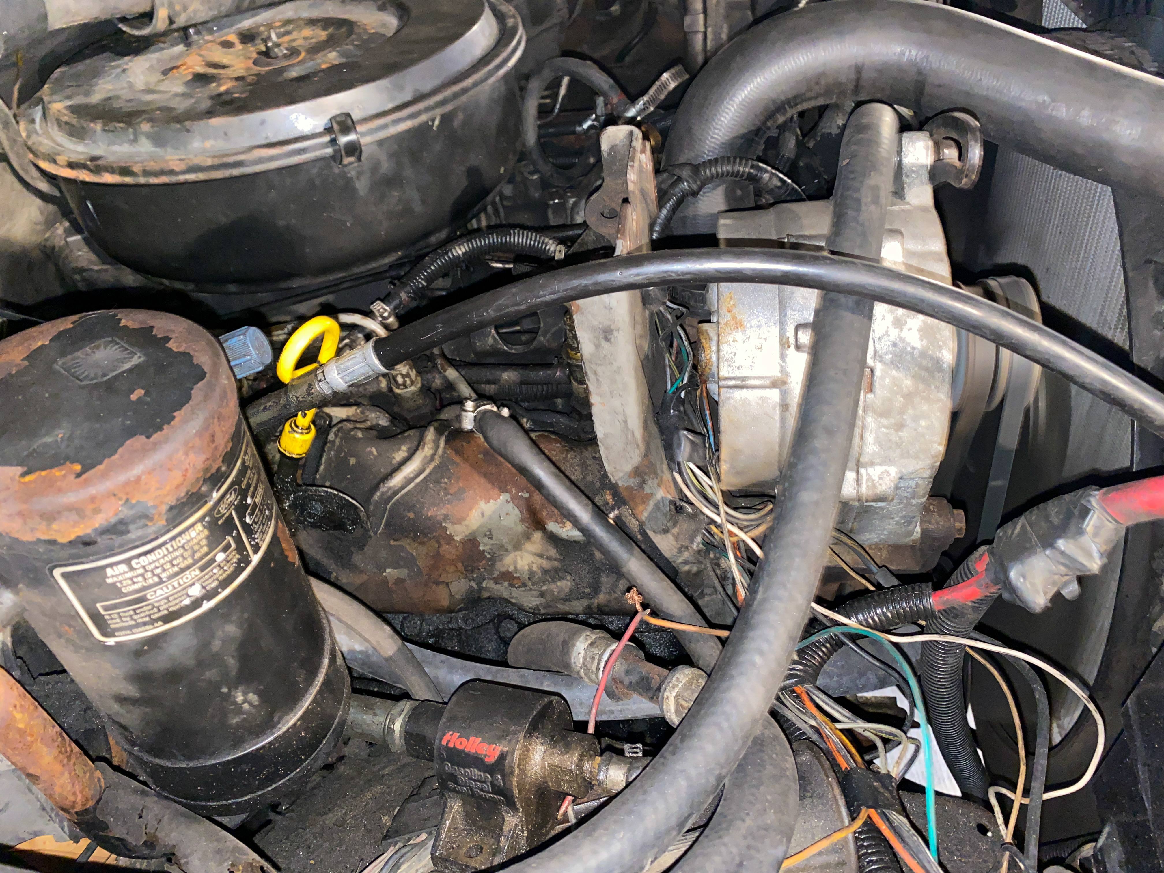

I just purchased my first diesel truck, 1991 Ford F-350 7.3l IDI E4OD RWD, and it’s running pretty rugged. A couple of days ago it was starting perfectly, idling for days, but once put into gear it really drags. There’s very little throttle response, it takes forever to get up to 45mph(max speed), it’ll buck and shudder if pushed anywhere close to hard (acceleration wise), and when climbing gears, right now, it has a tough time shifting unless the accelerator is released enough for it to catch up. That’s the overall standing of the truck the past few days, but presently what’s happening is, it won’t crank and start unless I have a helping hand in the cab while I manually give it fuel from under the hood. After she starts up, it’ll idle for days, but all of the same symptoms I mentioned before still take place. Being the newb that I am my gut says there’s an issue with fuel delivery. But, before I go swapping parts because I don’t know any better, I wanted to consult some experts, to see where I should start poking and prodding for some answers?
Below I’ll copy and paste bulleted notes about info I got from/about the previous owner also so you get a better idea of what we’re dealing with here... I’ve also got pictures and videos to accompany for what they may be worth! I have access to tools, gauges, etc so I can try and provide whatever readings may be useful.

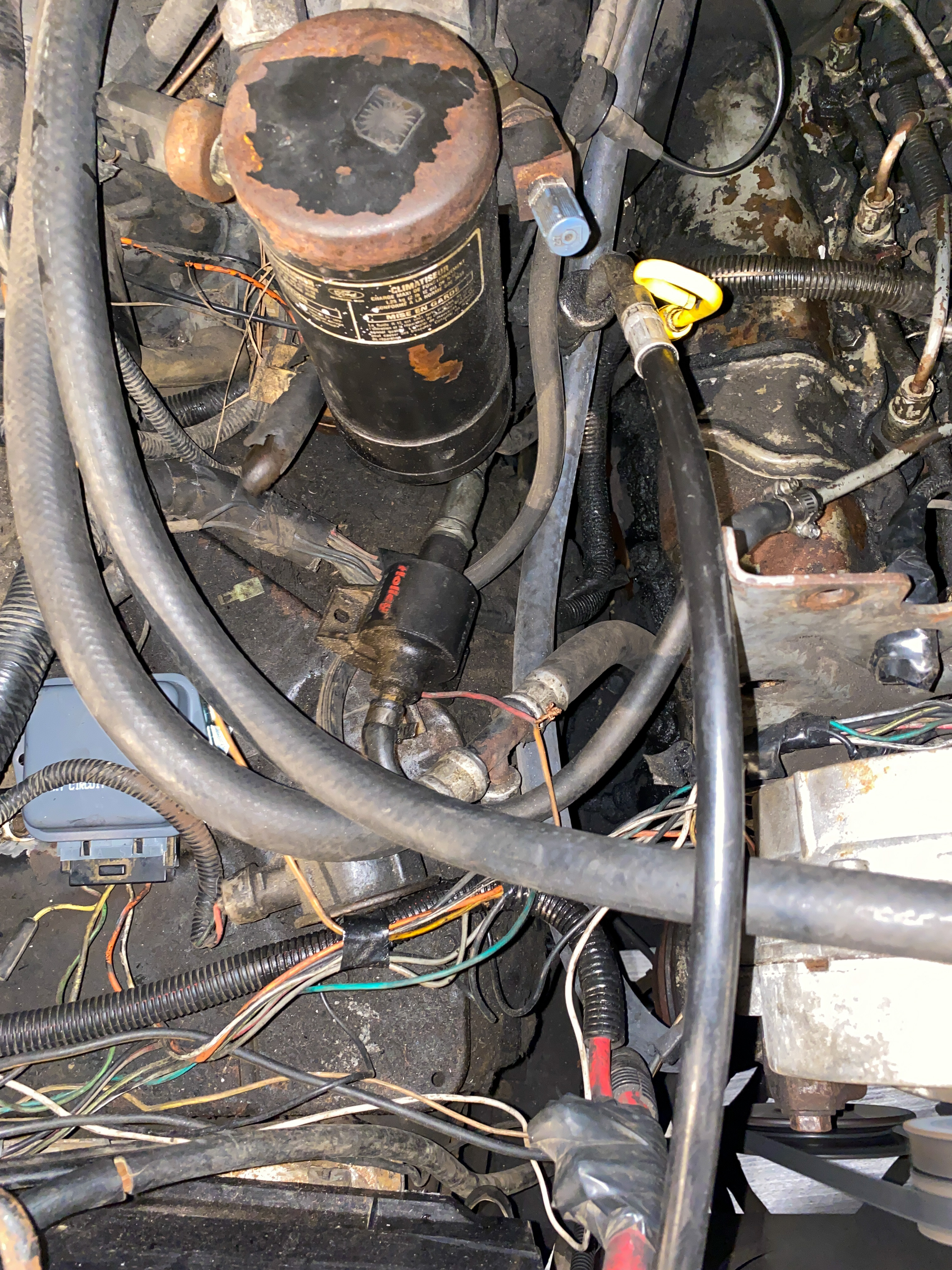

-Replaced IP, and lift pump. (with Holley MightMite[Located in engine comp, not correct I know, his setting is 7psi.]) I’m not certain if he just bypassed or fully deleted the lift pump.
-Removed entire OEM fuel filter and heater assembly. (That space is where the Holley E-Fuel pump is located)(no filter)

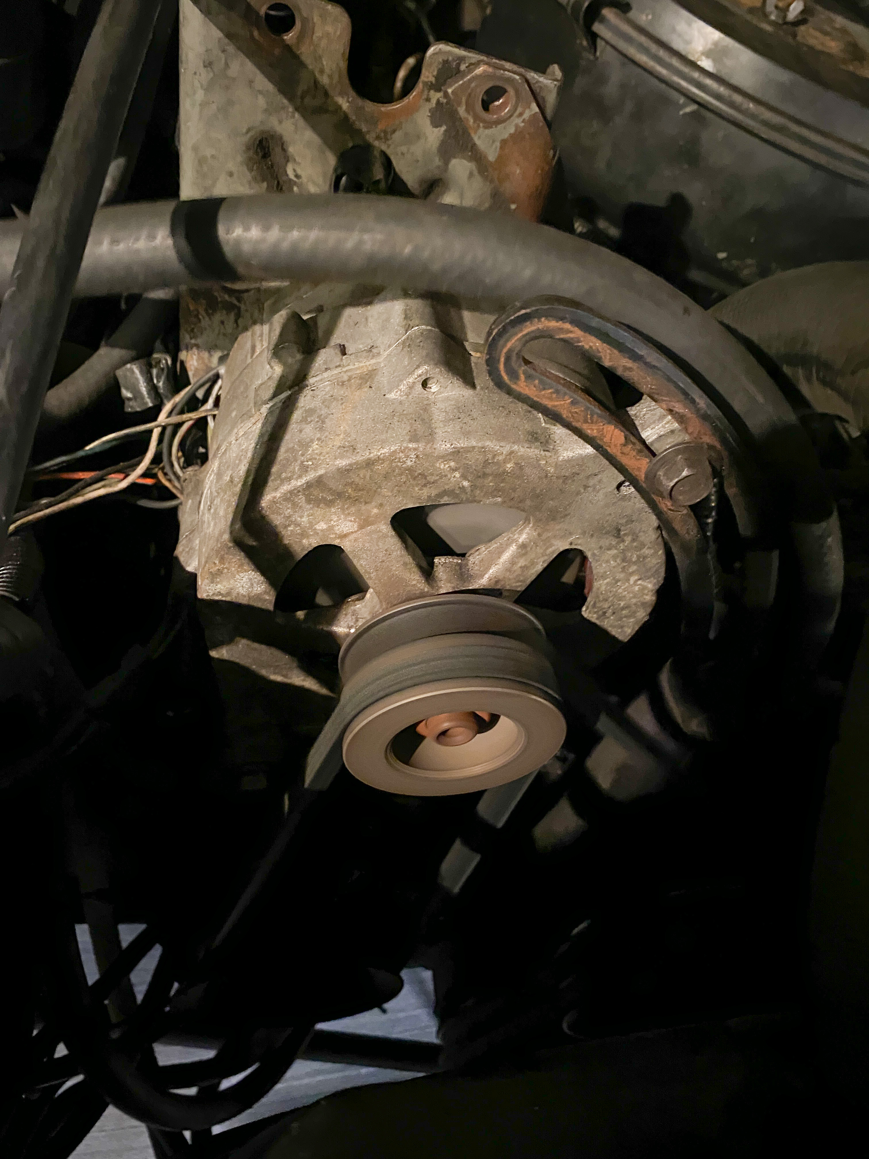

-Ambulance alternator? He said he put this “brand new, ambulance alternator in. It’s rated at 160A.” (He had to replace the voltage regulator before I could drive it)
-New voltage reg.

Thanks 79jasper! So, I’ve made a little headway in the process of elimination but the deed isn’t done.. So I call on you again! So I tested and relocated the Holley pump, because it works and everything was closed yesterday. The pump is just ahead of the FSV and is providing a constant push of fuel. Today I went over to affix the pump to the rail and test drive, below are bullets describing how it went;

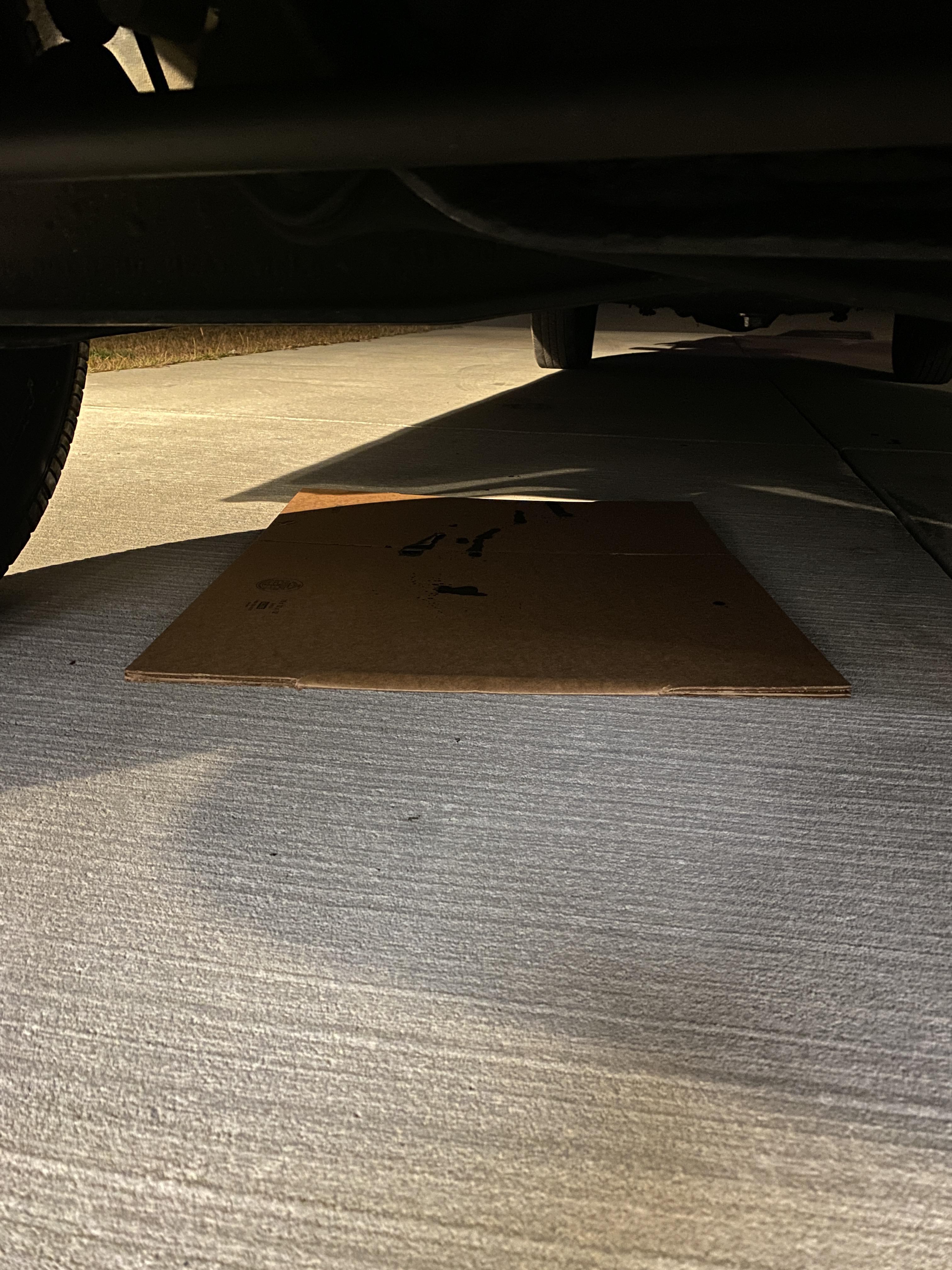

•Looked under chassis, losing a little oil. •Restarted no problem, died again in reverse.
•Restarted no issue again, started to become sporadic in idle, but drove it home gently.
•Parked in driveway, and let it idle just to watch gauges.
•Became more sporadic, dropping and spiking +/- 400rpm until it finally let go and died.
•Looked under the chassis again and there was a decent puddle of oil (dark dark oil, I think it’s oil atleast...)
•Crawled under to try and pinpoint the leak, the starter is covered in oil and dripping onto driveway.
•Checked oil level, even with the leak it’s still a decent amount over where it should be according to the dipstick.
•Checked trans fluid also, to make sure that wasn’t part of the hesitation in gear shifts, according to dipstick its overfilled also.

I didn't see where you have a fuel filter in the system; have you checked it after it died in the driveway this last time?
The dying and poor running is still a fuel delivery problem. The only way you're going to solve for it is to place a fuel pressure gauge inline and watch it while it is acting up.
