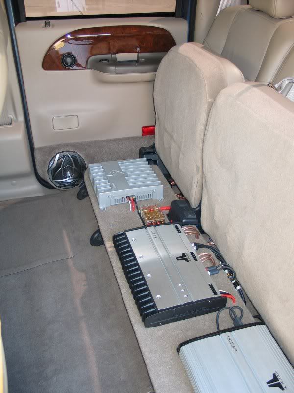

in my photo you can see a 4 circuit fused distribution block...using
4ga wire thats been run from the battery...the distribution block
is between the 2 amps w/ the RED cables run in and out of it.
this block is good for 30+ amps
