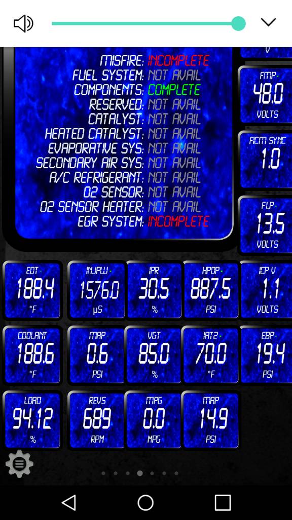

So I have done some work to my truck and I will get into that in a minute, but now I have an issue with it will start decent cold and runs okay until the ECT and EOT reach about 130 degrees and then it will continue to run but runs rough sounds like a miss, no throttle response, no power in drive when hot, no smoke, and no codes. It has stalled out on me. I have unpligged the icp to no avail, sometimes it will restart other times it won't even with the icp unplugged. Now the kicker is if I rev it up to 2k rpms in park it runs like a beast and all the issues go away. Then it returns to idle and the problems are back. I am at a loss racking my brain here.
What I have done:
So this all started with a cyl 3 contribution code, I fixed that with a new pushrod. I removed all the injectors and cleaned the spool valves and resealed all 8 injectors, did new nipple cups and o rings, new stand pipes and dummy plugs. I have pull the valve covers off and checked my torque for my bolts and stand pipes and dummy plugs. Checked my fuel bowl for bubbles and I have none.
Monitoring everything with the torque pro app, I will attach screenshots and try to explain them, I also have video showing what it's doing.
So the pictures show one revving up to ~2k rpms, one hot idle maybe two, and one right when it gets to running rough.
I would be happy to do more diagnostic stuff but I have the turbo off (just cleaned it up), ipr valve off (had remnants of Dorman gasket on the screen) waiting to get a new screen, ebp valve and tube off just cleaned those out.
