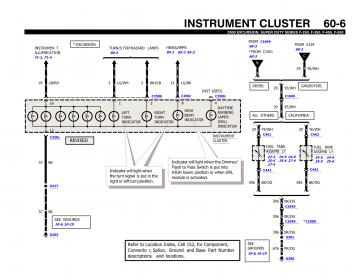

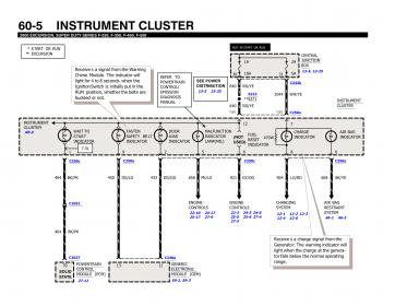

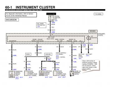

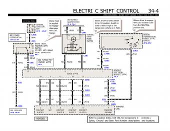

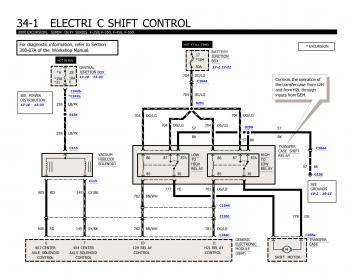

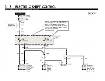

There ya go, Bro..
there's your wiring diagrams..
if you need to follow one to another page I didn't post, tell me the number in the upper rt. corner, and the number you want to go to..
