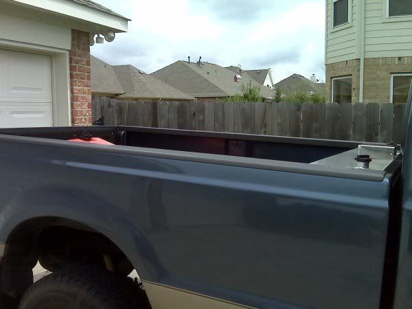

My 50g tank takes up a shallow 10 inches of bed depth - even with the tank, I still have more bed space than a short bed would have.

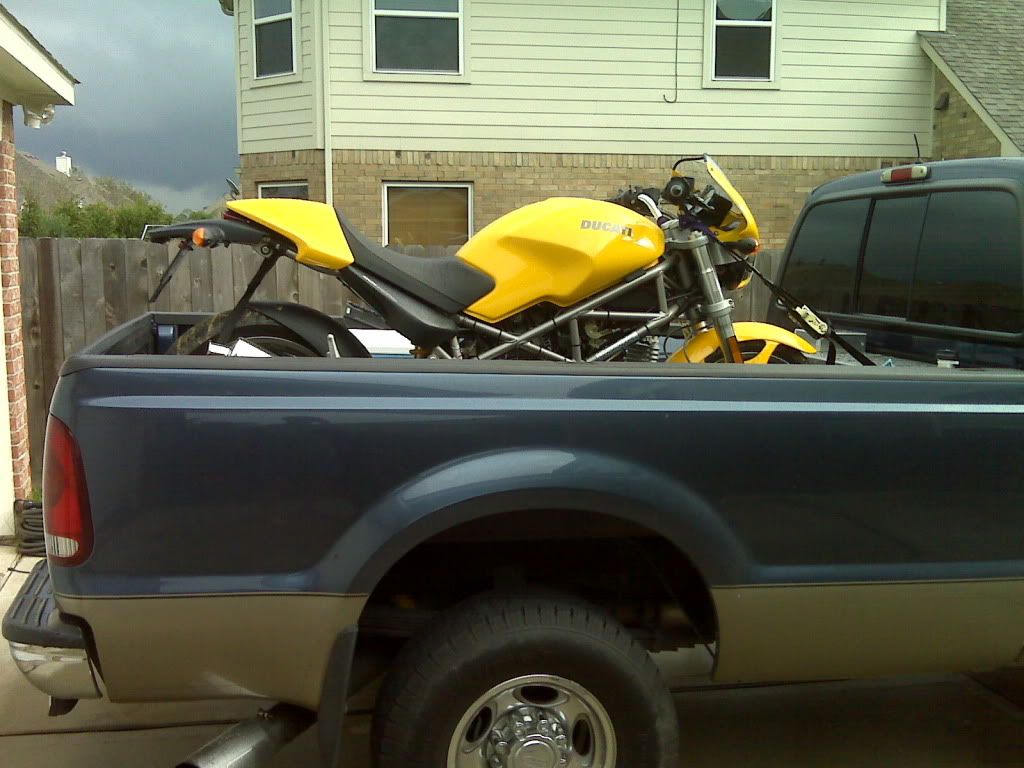

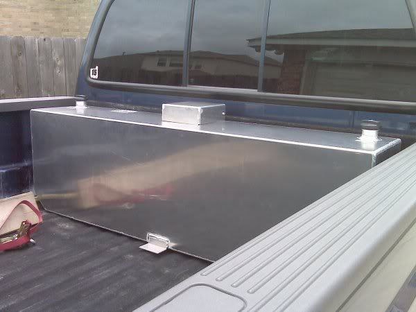

Here's some pictures to give you an idea of how little the space consumed is -
How many gallons of fuel does it hold?
that one holds 50 gallons, I think (now) they make it in a 40 gal....which provides a combined total of nearly 90 gallons
I added an optional filler neck/port on the passenger side so that I could fill both (factory & aux) tanks at RV or Truck Islands.
My less fancy (smooth finish aluminum) was slightly cheaper....they have options that include tread plate finishing too.
