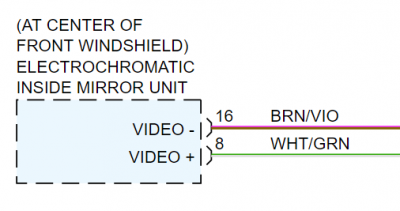

It is possible as the ford screens and mirror are signal sensing units. Meaning that even if it sees a reverse signal to the mirror or radio it wont go into the mode unless it sees a video signal.
Easies way to tell is to check the connector at the back of the mirror for the video wires.
