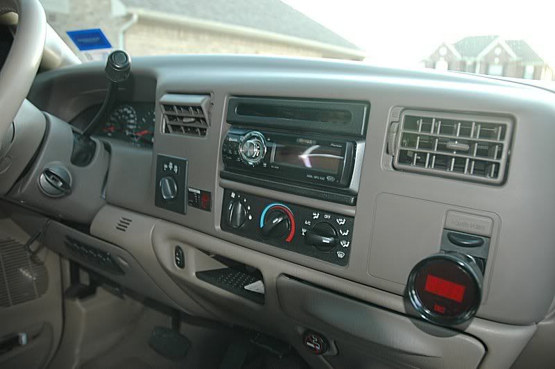

the 99-04 is din-and-a-half not DOUBLE DIN.
you can install double din units but you have to trim the dash
bezel.
heres proof its not double din (see the small useless pocket left
over when installing a std SINGLE DIN unit) -->

<hijack>
what is in your power outlet? volt meter?
did that pad in the cubby next to the adjustable pedal switch come with your truck? looks like it did. mine doesn't have that, and any time i keep stuff in there, my dptuner makes it fall back out :(
</hijack>
<hijack>
</hijack>
yup...voltmeter <cyberdyne> plug in version....good for monitoring
the condition of the batteries (when not running) or the output of
the alternator (when running).
the pad came from an excursion...and it is NICE, keeps crap from
sliding and it fits perfectly...you can cut a bit of that no-slip <under
rug> material and put it in there...thats what ive used in the past.
nice thing 'bout this rubber insert is that it has a lip on it...almost
like a shallow bowl....so anything that falls deep into the pocket/cubby
can be pulled out by pulling the rubber pad out.

so where's the trimming? the top of the opening is level with the air vents in both pics, bottom doesn't have anywhere to go...right? or my eyes tricking me
