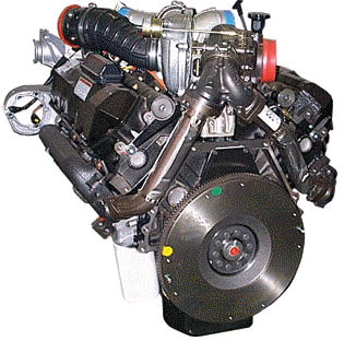

the exhaust system on these trucks is relatively simple but there are a few pieces involved Here is a picture to give you a better idea of what you'll be dealing with
you see the exhaust that comes out of the manifold it goes into the up pipes on each side which are directly above the flywheel in the picture and these connect to the collector manifold or baby's butt. The collector manifold has a mounting plate that attaches to the exhaust inlet flange of the turbo.
each of these connection points is a potential location for a leak, leaks are usually identifiable by a soot deposit, to look for soot deposits you'll need a mirror and flashlight to do a comprehensive inspection.
