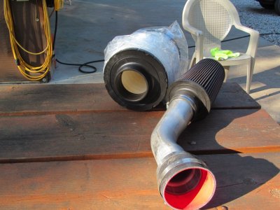

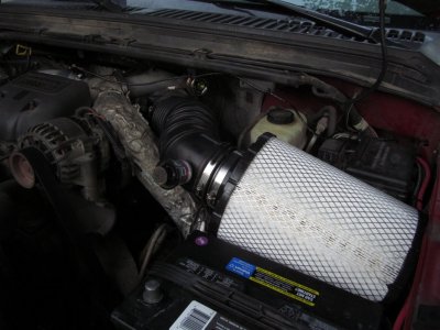

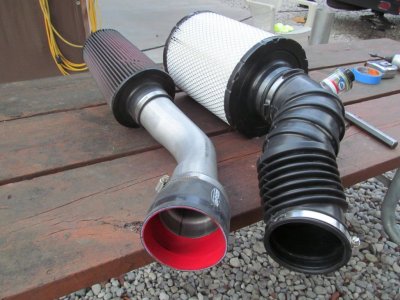

Anyway,rant over! the connecting sleve at the trbo is 4",the k&n is 3".Thats a whopping 44% difference!I started out fitting some 4" od ss pipe bends together to connect the 6637,but decided it was easier to use the stock rubber boot because I have better things to do this time of year.I had to trim almost all of the batt box off, but everything fits nicely now with the filter missing all around by 1/8".I heated up a large drift pin and burned a 5/16" hole in the boot,then champhered it with a stanly knife so that the stock restriction indicater would snap in.I really dont know why.I just did it.I have not driven it yet, but at idle the noise from the turbo is more pronounced,so my wife will like it.In order to see if it reduces egt on my "test" hill,I will need to simulate the 14k # of the TH.Monday I will be hauling hay,but thats onl 7k at a load.I will run it down to the test hill on m-72 and try it.End of next week I have a back hoe job down that way so I will test it with the equipment trailer which coincidentally is 14k loaded.Then I need to find someone who wants a k&n setup!IMG_2375.JPGIMG_2376.JPGIMG_2377.JPG
Yes, that's nice work and I have never been impressed with K&N. That thing may sound like a small jet taking off.

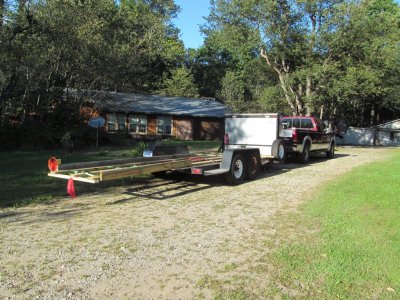

I have theIMG_2397.JPG old tilt deck eq trailer hooked up to get a load of steel roofing in Manton,and lumber in Cadilacc tomorrow.This will only gross about7k,but input is input!
