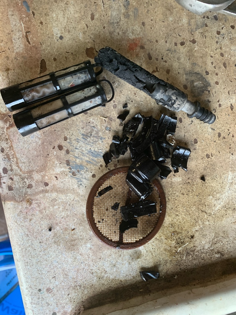

Changed oil last week. Dropped gas tank today and found fuel pickup literally disintegrated. Cleaned out tank and did harpoon mod and Hutch mod with strictly Diesel kit. Also breather lines on fuel tank were disinterested leaving open acces to tank on both ends. Seems to be running much better. Time will tell.
This is all that was left of pickup that was in the tank.
