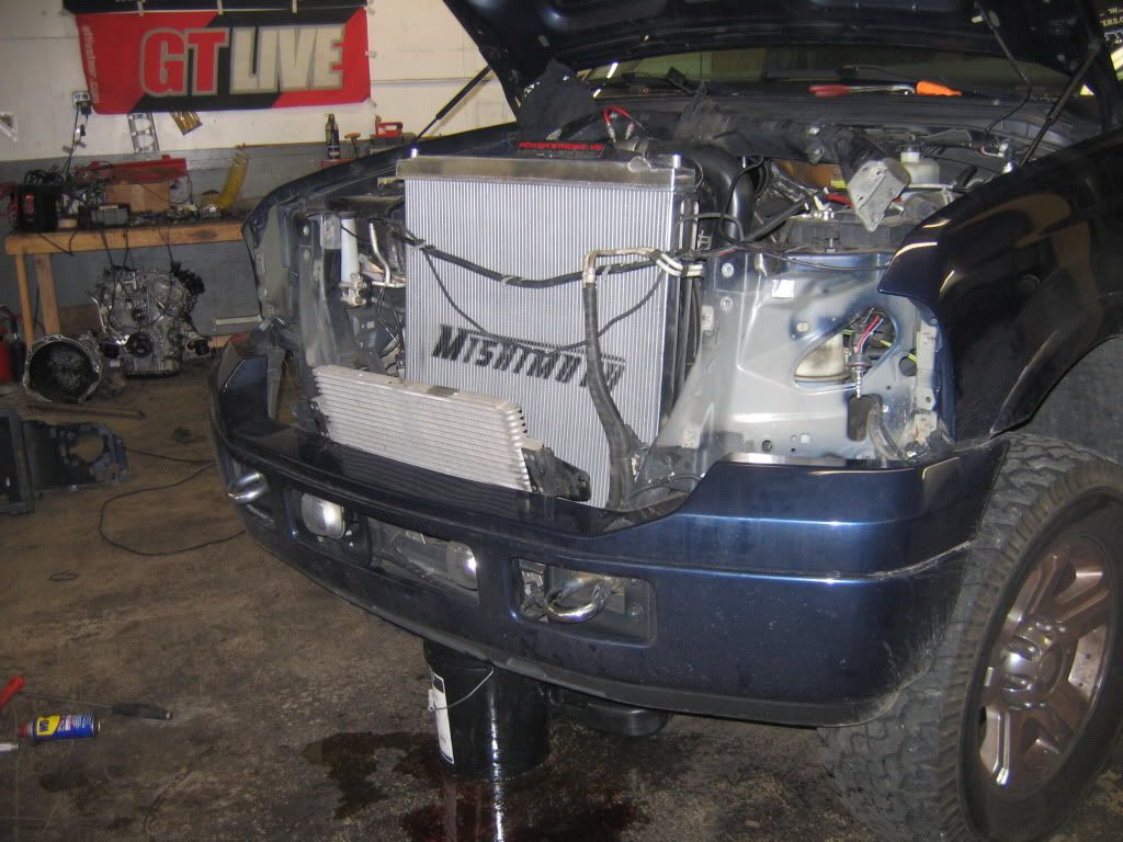

Alright, well I meant to do an install guide on the product, but the batteries died on the camera. Started working on the truck while I waited for my wife to return from work, she was stopping by the store to get me some batteries on the way home.
This is how far I was once she arrived.

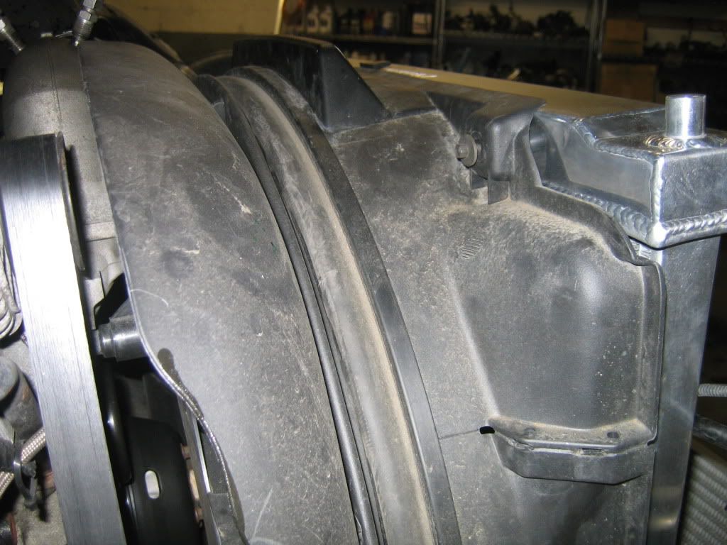

Fan Shroud on back of new radiator:

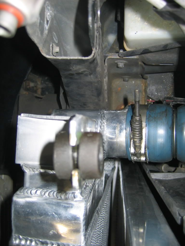

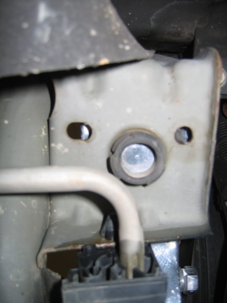

Mounting points on radiator:

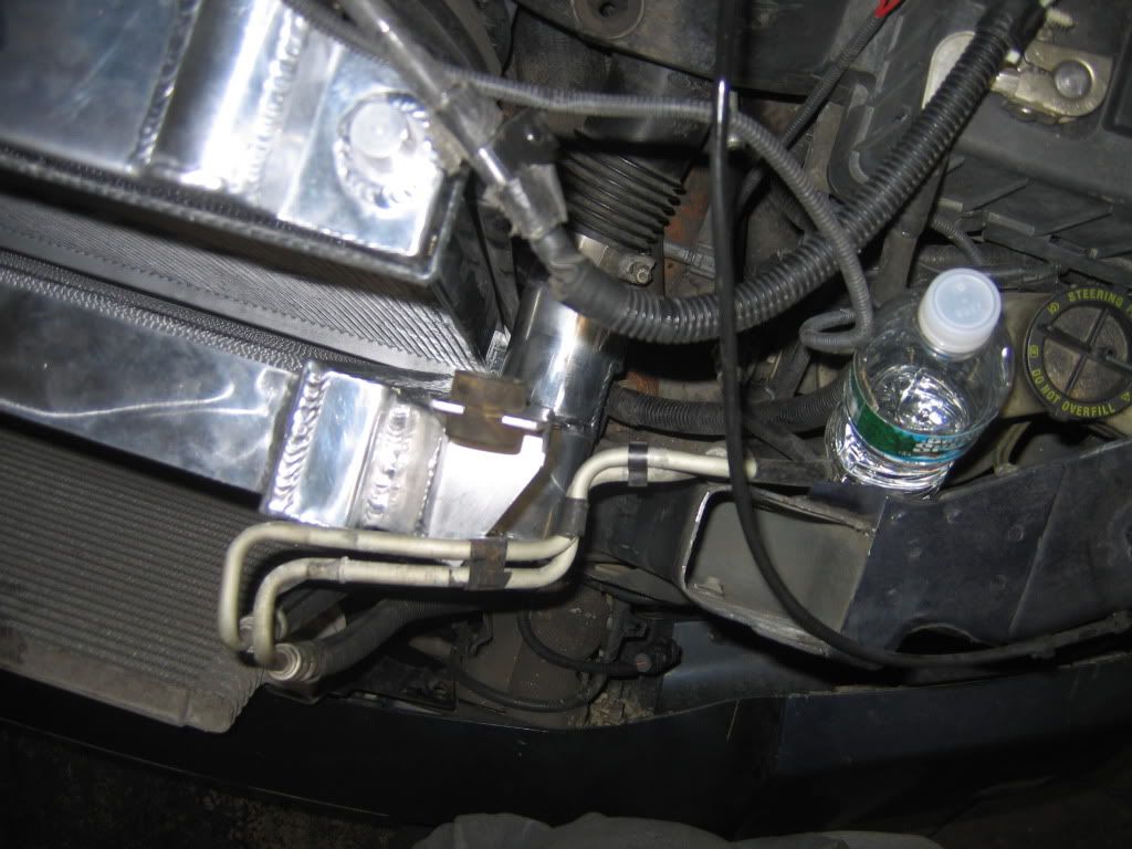

Transmission lines in!

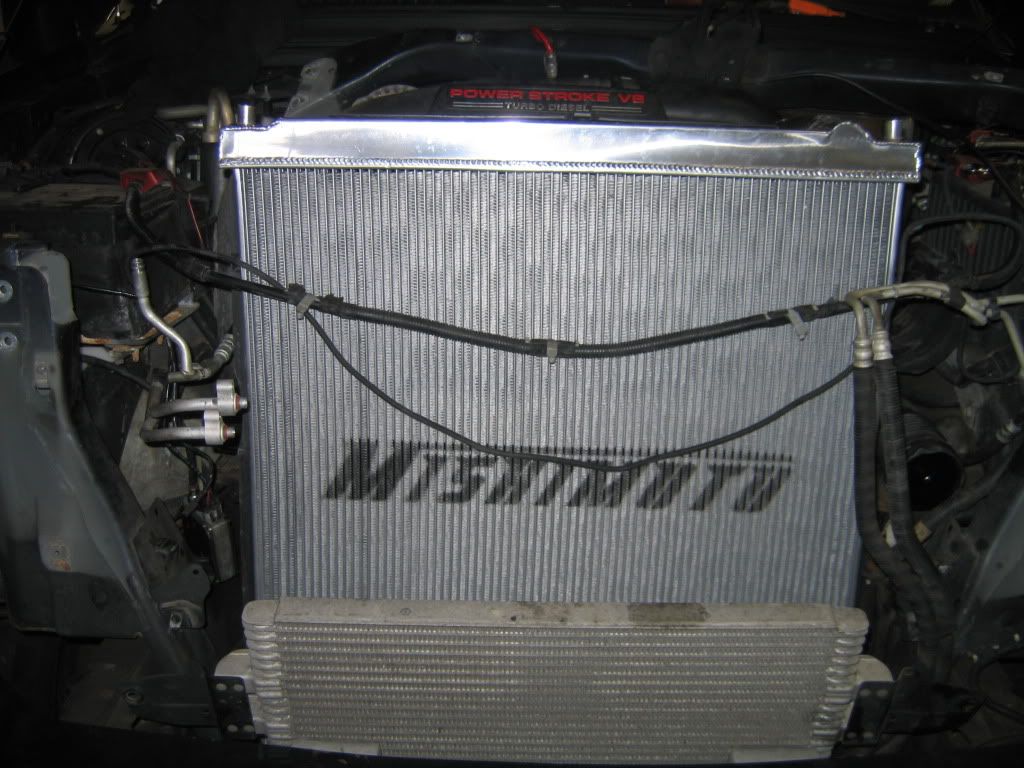

From there, I installed the intercooler. The process was extremely simple, remove OEM radiator/Intercooler, and install Mishimoto parts. No modifying anything whatsoever.
Charge piping connected:
The intercooler fits perfectly:
Pictures of the final product:
I can’t stress enough how ridiculously easy this process was. Everything seems to run cooler for the most part, I’m not overheating, that’s for sure. Can’t wait to get on the dyno to see some numbers!
