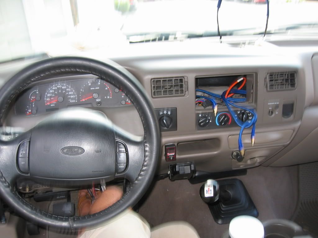

i too rock the wheelskin. pretty labor intensive to get it on there, but the result is nice. i had the superbusted vinyl piece on my truck.
here's a pic i took while putting in my chip...quality is lacking but you can kinda see the wheel.
good luck,
paul
