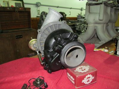

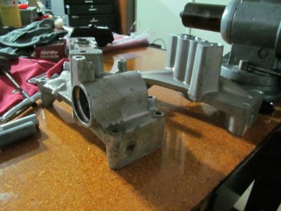

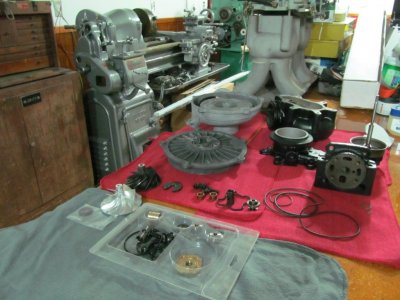

Today I got the exhaust turbine pieces blasted and painted.I used 1500 deg paint so if it burns off I know Ive had bigger issues! Tomorrow morning I'll bake them and try to get this guy assembled.IMG_2311.JPGIMG_2312.JPGI didnt blast the bearing houseing because there are so many small iol passages and it would be hard to insure that I got all the media out when I was done. Instead I gave it an overnight soak in a bucket of hydroflouric acid,followed by a rinse in a soda solution.That got 90% of the rust so its good. Cant see it when its on the motor anyway!

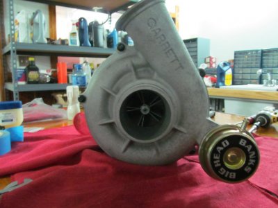

UPS brought the non-exhaust valve pedistal,so I loaded all of it up and headed off to the IH dealer.I'm going back over there tomorrow to talk to the mechanic (he was on a service call).He did manage to get all the rusty,broken bolts out of the heads,so that was good news!IMG_2320.JPG
