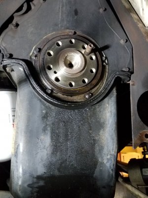

    It's been a week or so since I finished up the work under the truck. If your ZF has as many miles as mine does I would recommend changing the input shaft seal as well as the inner boot on the shift tower. I towed my boat (8500#'s) for 4 hours yesterday and she did great. Tows better and gets slightly better mileage it seems. Below is a pic of the leak from the input shaft seal.
