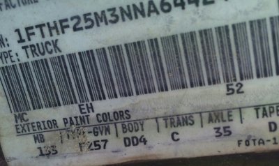

This is a pic of the tag on the inside of the door that I am repairing. Can you tell me more about this rear end. Thanks for the help!uploadfromtaptalk1444412999455.jpg

A 35 axle is a:
Ford/Sterling Full Float 10.25 axle with 4:10 gearing and is an Open Differential.
So with this swap, you would have the same gearing as you do now, but gain a Limited Slip Differential. So it should behave the same on the roads as it does now, you just have a Limited Slip, which can help in a 2wd truck.....
I'd say, if the new one checks out, buy new U-Bolts, routine maintenance, check out the brakes, and swap it out....
