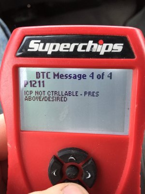

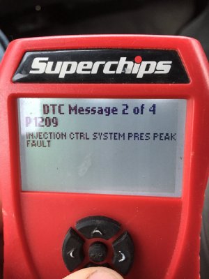

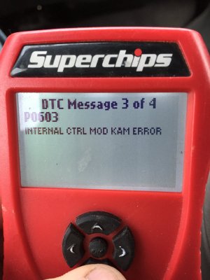

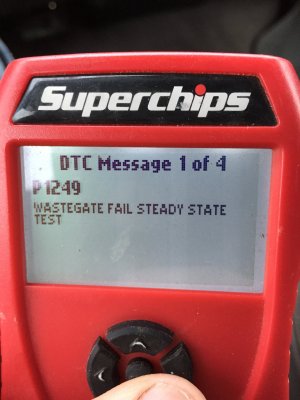

I have a 01 7.3 with a superchips programmer, 165k. I recently started noticing when under a pulling load or heavy excelleration the check engine light will come on and read the following codes. IMG_0246[1].JPGIMG_0245[1].JPGIMG_0244[1].JPGIMG_0243[1].JPG
I wouldnt say they all come on at the same times, but they are all frequent. I also notice a flat spot in excelleration, alsmost like a top end bog. Any ideas on where to start would be great.
Fer starters.....The MAP sensor is detecting Over Boost, putting the PCM into a De-fuel mode (the flat spot) and setting the CEL & Code.. You need a BPRV (Boost Pressure Relief Valve) between the "Y" pipe and the MAP sensor. And a Better than OEM.. Waste gate controller
If you don't have one. If you do.. it's not working right.

These codes also have been coming up when the programer is in stock mode, where as I havent had any CEL in previous years. Makes me wonder if I have a waste gate controller problem, in which it is stock. As far as a BPRV I have not put one on the truck since I purchased it 8 years ago. Can you give me some direction on where to find a BPRV and a better waste gate controller?
Most any of the SDD site sponsors will have 7.3 BPRV's.. and aftermarket WG controllers. dieselsite.com comes to mind.
Check your vac lines running from the MAP to the WG & intake snorkel for cracks, leaks and dried/old ?
Stock or on a Tune..Once those Codes are set in the KAM, or elsewhere.. your 7.3 is in a de-fuel mode.. until you erase them Completely. Yul be down on power due to fuel pressure being decreased. May be a "Duh" to ya but worth a mention ?
