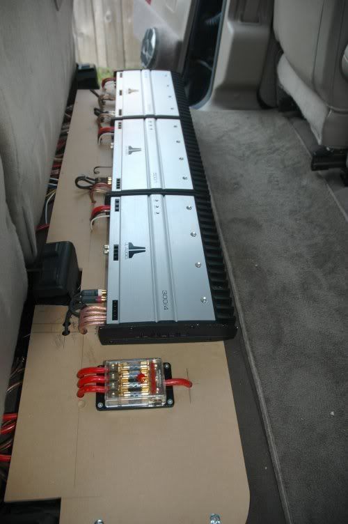

spaghetti, no more (new amp rack installed)
Well I cut a bit of mdf (dont like it...should have used 1/4 inch
laminated plywood like before).
Got all this laid out, holes drilled, thinking i had extra carpet
roll over the garage...guess what...bit of carpet i was gonna
cover the board w/ isnt big enough ! UGH !
Ill use this as the opportunity to make some minor changes to
the mounting board and cover it w/ matching carpet (like i'd done
before)...
heres some updated...photos....w/out carpet...
Thanks -
The box isnt really "PERFECTLY" sized...but theres so little room
back there its hard to get anything back there...and still have
some storage.

nice work there....don`t have any over heating problems with the amps underneath the seat?....:sweet
nope...not w/ these amps anyway...which is why i did this 'upgrade'...
i had an older fosgate monoblock 200w that was melting carpet
(145* surface temps on the amp/heat-sink) and it was doin' thermal
shutdowns when pushed hard.
so i pulled the fosgate 200w and installed the JL Audio 500/1...more
than DOUBLE the output and much much CLEANER amp.
If you notice in the photos the heat sinks are ALL hanging over
the mdf mounting board...so they get plenty of air circulation...NOW...
even when driven to their peaks.
the seats (when folded down) angle back & so theres actually LESS
room at the back (near the hinge portion) than near the front.
the way the amps are mounted now, there is NO contact w/ the seats.
I COULD core some holes in the board, under the amps for some added
cooling but it isnt necessary.
the amps could STILL be pushed back a good 2inches if you wanted...
just cut the board shorter to maintain the heat sinks "hanging" over
the edge for good air circulation from below thru the heat sinks.

yeah i had the same problems with my fosgate amps...always needed to install a cooling fan if they were mounted in a confined space...hopefully this summer i will be doing some upgrades to my factory system....:HB :music
I had some temporary fans installed...FOUR of the quietest i could find...still
wasnt enough cooling for me and i could STILL hear them running.
I also didnt like the idea of having the fans blowing on my
passengers ankles...
