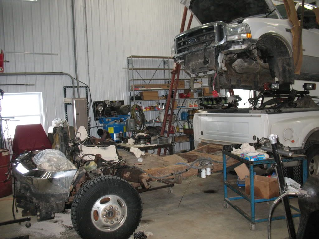

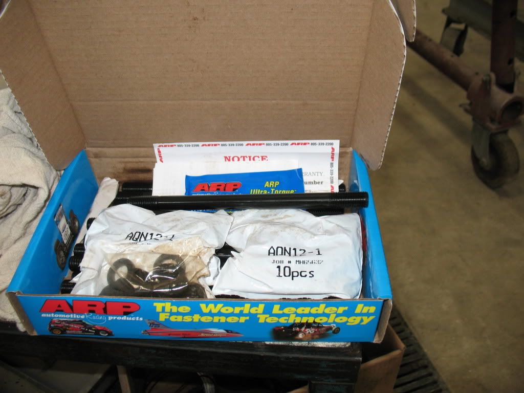

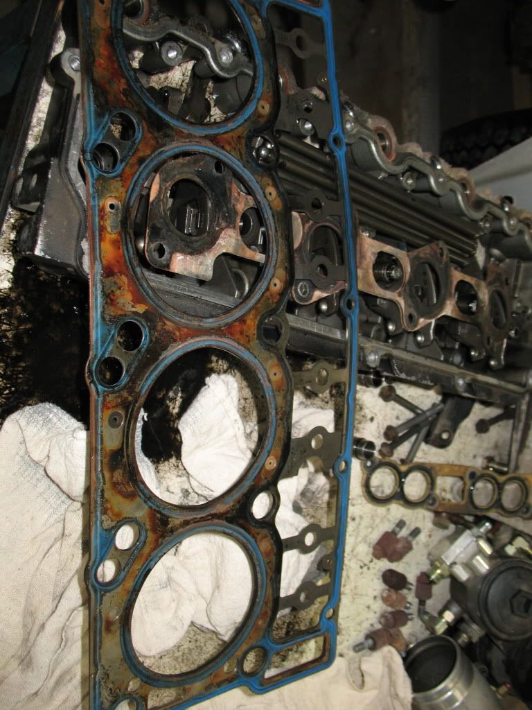

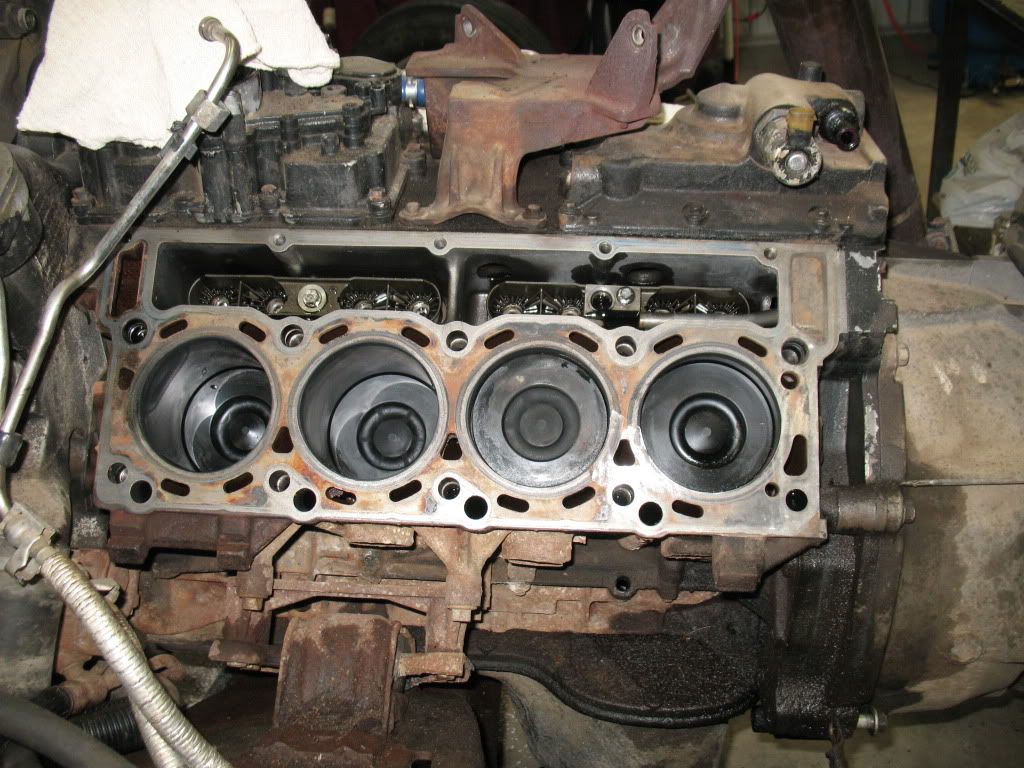

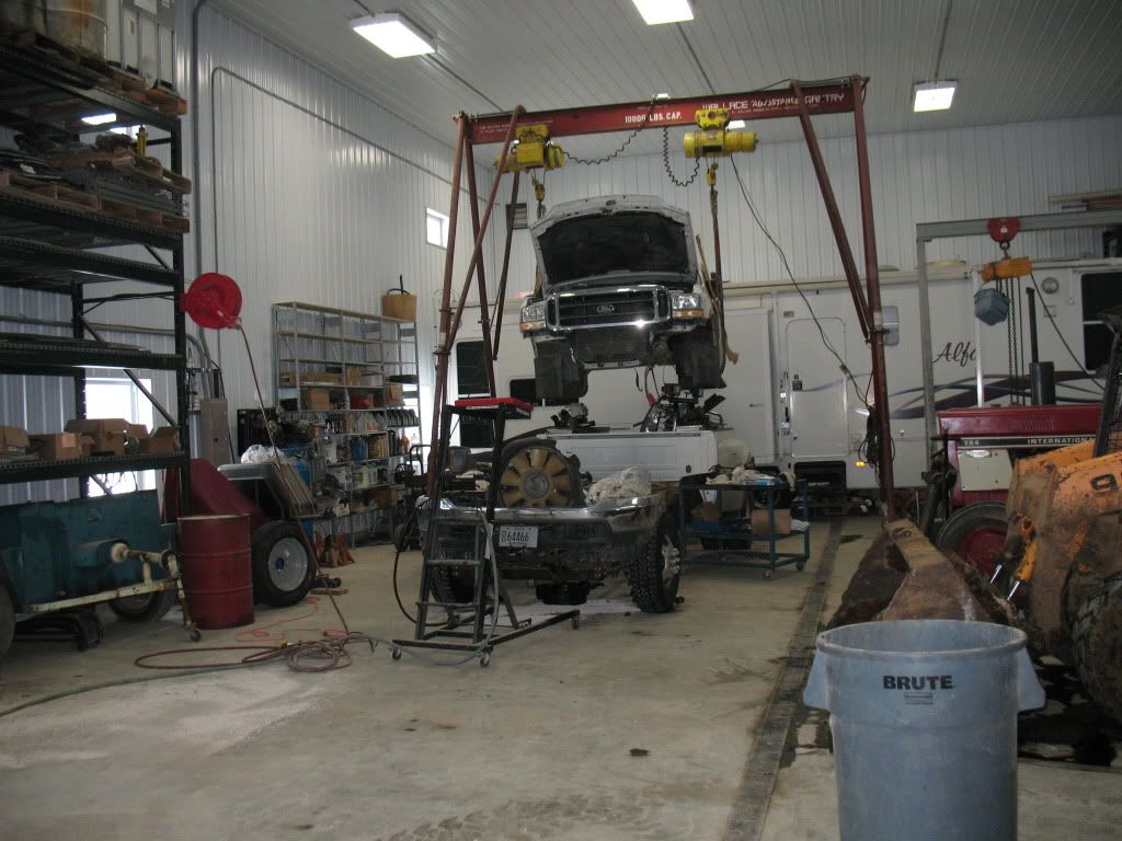

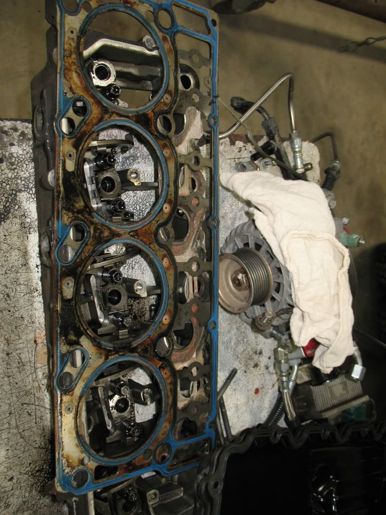

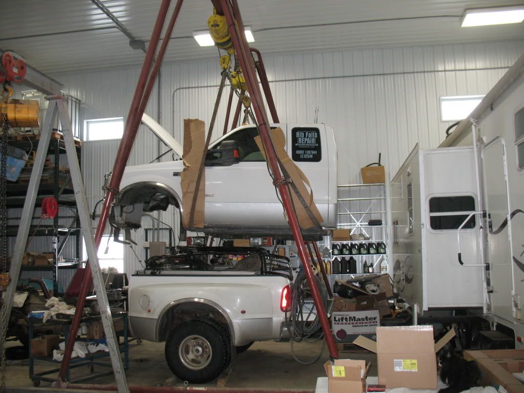

Finally made time to get head studs and gaskets in shorty, kinda had to, was going through around a gallon of coolant every 100 miles of light towing. Got the engine tore apart early yesterday (started at 3 am :dizzy ) and heads and injectors sent out right away. Once you get the cab out of the way, working on these is a dream. Putting a new South Bend dual disk street clutch in right away, no more dual mass flywheel for me :sweet Here are some pictures
I don't have a 2 post, but I do have a hoist
Its a stacker, nice not to have to work under the cab
Part of the solution
Puking gaskets

My cousin will be doin that to his 6.0 here soon at our shop. Sure does make it so much easier to work on it without that cab. My bro pulled the cab on his 98 F150 cause of a burnt valve. I thought it would be a pain to pull the cab. I would have just pulled the motor but after lookin at what all he had to do to pull the cab, that is the way to go! Just never thought it would be that easy. Was your truck burnin coolant or leaking it?

It was puking out the degas bottle. Eliminated the EGR cooler a while back to remove that possibility.
You guys admiring the big shop gotta remember I work in this thing every day for a living, otherwise I'd be doing it in my driveway like the rest of you. I also don't even own or rent a house. Yeah my wife really does love me :D
