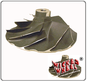

when my truck was all stock i could hear the fan kick on when towing. but know that i did the DIY intake and muff. delete i here a whole diff. sound also. it sounds like vacume when towing. made sense to me for the sound, with a better filter and flow.
Willing to bet, what you heard is turbo surge.... a wicked wheel will most likely clean that up....
Yeah what he said.
Wicked Wheel link click here
