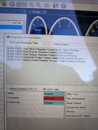

Getting an intermittant crank but no start. Only thing we've noticed is that it mostly happens in colder weather, especially in winter.
Usually happens after sitting over night or all day at the job site. Never known it to happen at operating temp. No consistency as to how to get it started again. Sometimes will start fine a few minutes later, sometime takes hours. No rhyme or rythem to it that i can tell.
Did it this morning after sitting all night. Worker called me said he took it home last night and now it would not start so I grabbed my scanner and headed over there. Cranks but no start. Pulled the codes and got the following. Tried clearing codes but they would not clear. Disconnected battery for a bit and cleared codes that way but still cranks but no start.
Any ideas? I've attached a picture of the codes and listed them below. Looks like problems with fuel pressure, crank sensor, and injectors but are they related or ?
Codes are
P0001
P0090
P0091
P0315
P2291
