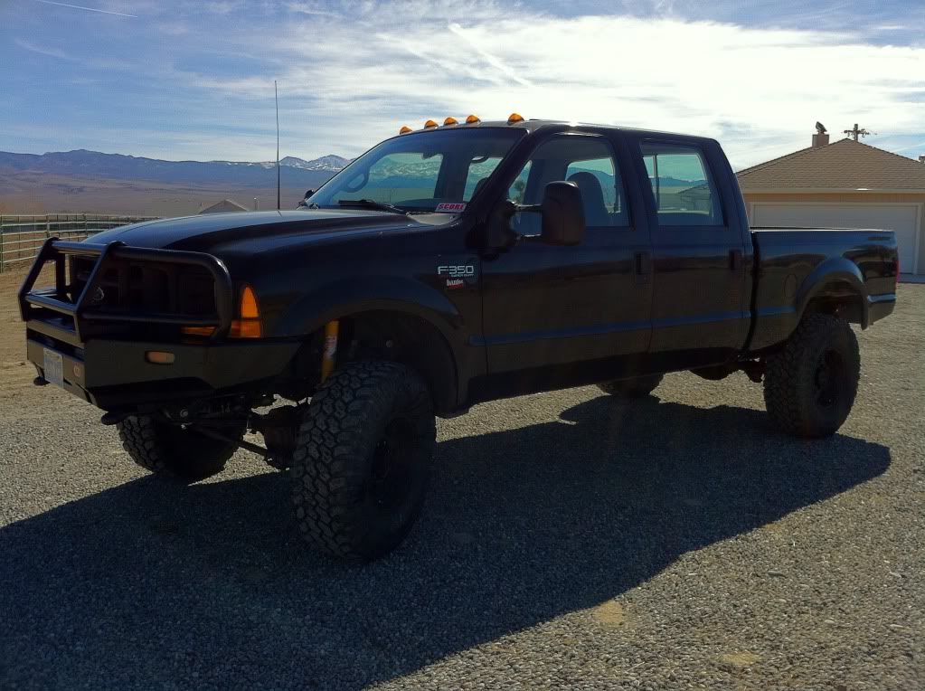

Thanks everybody. I'll be trying everything in the next few days.
here's a Picture of her.
