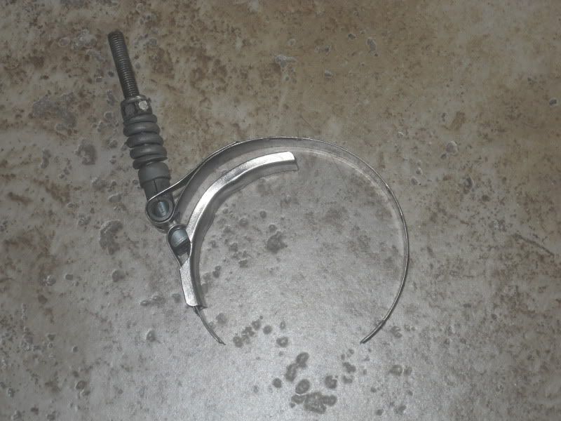

This clamp let go at 32PSI towing my 5er up a long grade.
