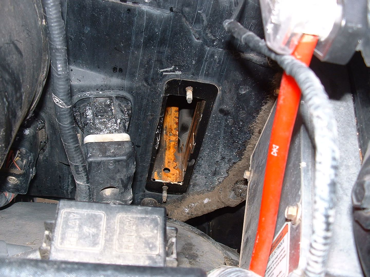

No, your PCM is not on the fender, that is your IDM on the fender, the PCM is located on the firewall underhood near the brake booster. Heres some pics of my install.
First,
Unhook batts....
There she is........
Unhook harness.....

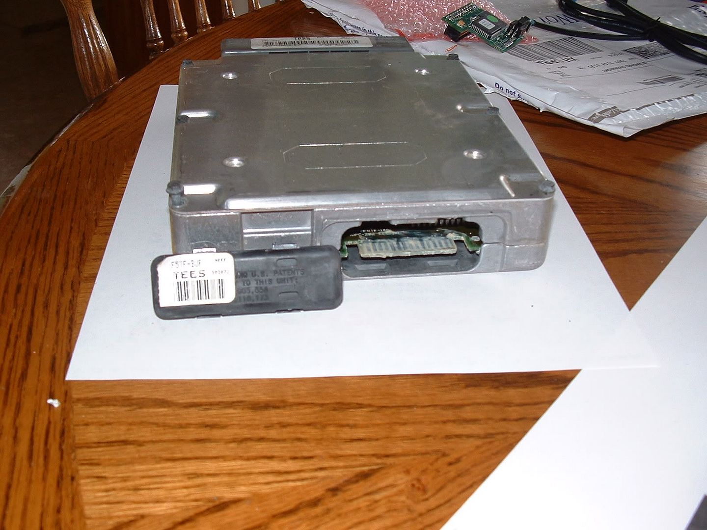

Empty PCM slot..... to get the PCM to slide out I had to take the stainless trim off and unscrew the inner fender and use a prybar to bend it down, if not the PCM wont slide out.

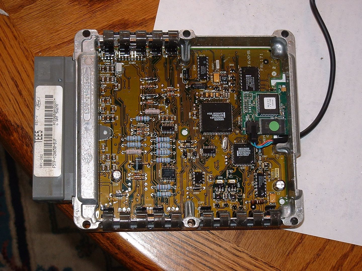

PCM in the house with the back side facing you, I pulled off the rubber plug where the chip will be located at this point.
PCM case after it has been split..........
Gently scraping the coating off the contacts with pocket knife, I followed with a 3M scratchy pad.
Chip in place on the PCM board.

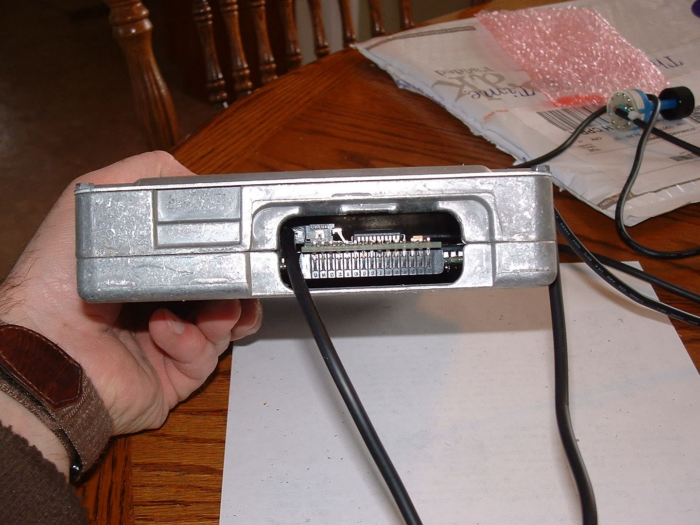

Case closed again with the control wire sticking out the back.
Install the PCM in reverse of removal, threading your selector knob in first then follow with the PCM. Find a suitable place on your dash to mount the knob and go make some smoke.:burnit
