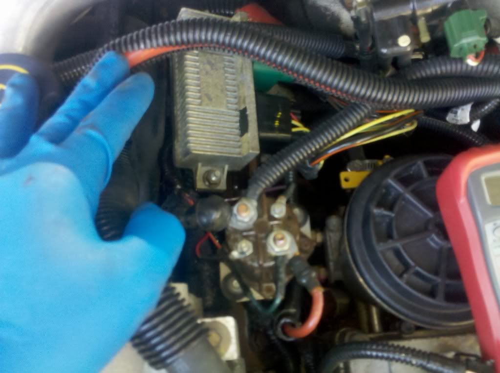

The silver thing in the back is the GPCM ( glow plug control module ) Sorry for the poor quality, cell phone.

i hope when you're saying you get no ohms you know that the more ohms (a measure of electrical resistance in a circuit) the worse the problem. any circuit consumers like a resistor, or a motor should have resistance, but in a perfect circuit there should be no resistance at all. Resistance can be caused by corrosion, damaged wires, failing components, etc. the only time you should worry about resistance is if it is too high, or if the meter does not give a reading at all indicating an open circuit. then to diagnose the open, you can perform voltage drop testing. hope this helps, if not give more details and hopefully you'll get her all fixed up. if you need it, i can give you details on testing resistance in a circuit, or voltage drop testing
