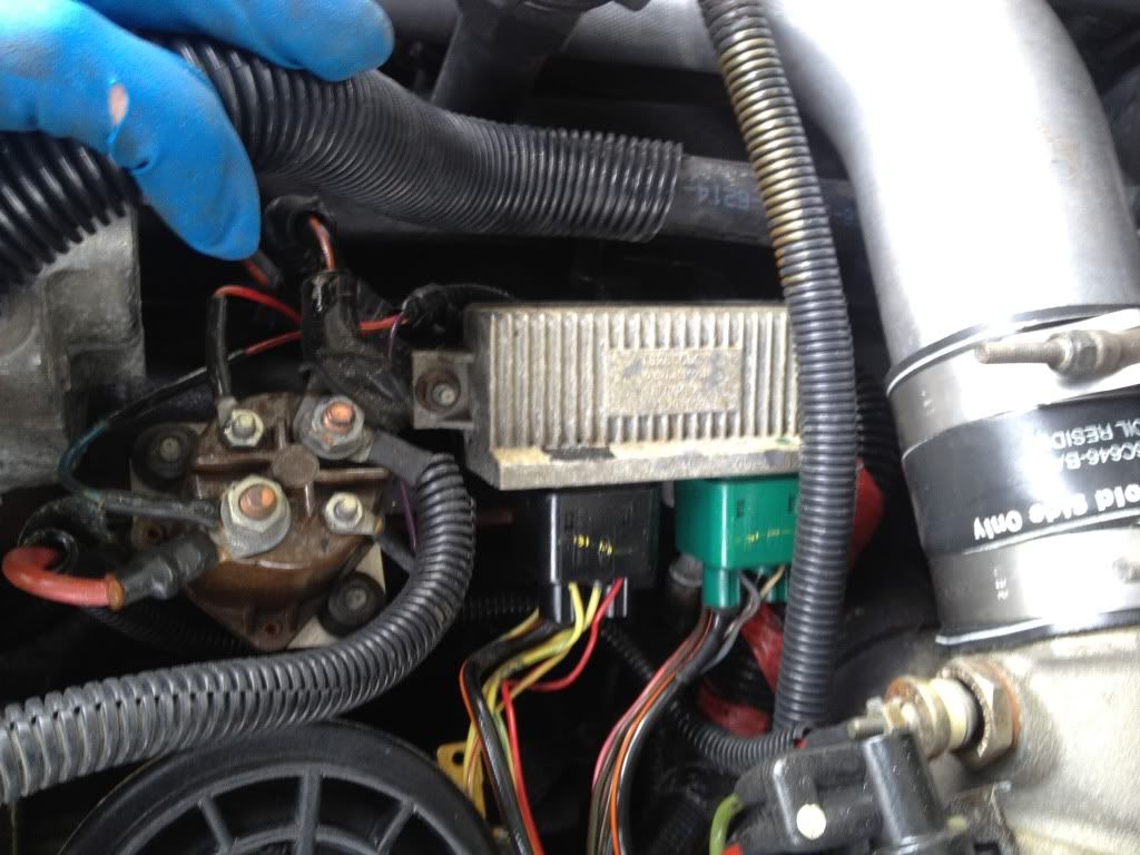

toobsluver
Jan 9, 2006
158
Jackson, NJ
so I am working on my glow plug situation and I can't figure out what the brown relay is for that is in the left side of the image. It looks like there is a power wire coming off one of the posts that is black with an orange stripe that seems to be going to my GPCM (glow plug control module). Any ideas?
