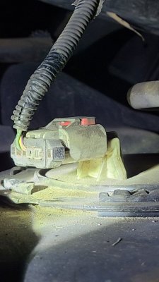

Thank you so much for the replies. As per your advice, and out of an abundance of caution, I have dropped the tank to the point of disconnecting the sending unit. Disconnecting the connector in this picture is proving more difficult than actually dropping the tank. Is there a secret to getting these off? Or a better question - is there a resource that tells how to disconnect these and other Ford connectors? Despite looking, I haven't found one yet.

That red tab is a lock. Using a dental pick, slide the red tab away from the locking tab in the male side of the connector. A slight push down on the male side tab, and pull.
