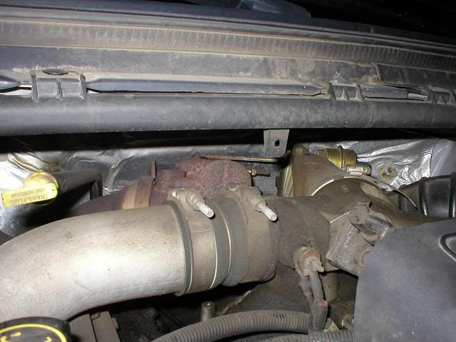

Intercooler boots...
these things..
see here how it's dirty and oil to the right of the boot? Boost leak.

Now, THAT'S what I needed... pics! Haha... I'm a visual person. I know just enough about these things (autos in general) to get myself in trouble and this is my first diesel ever so I'm really learning here.
