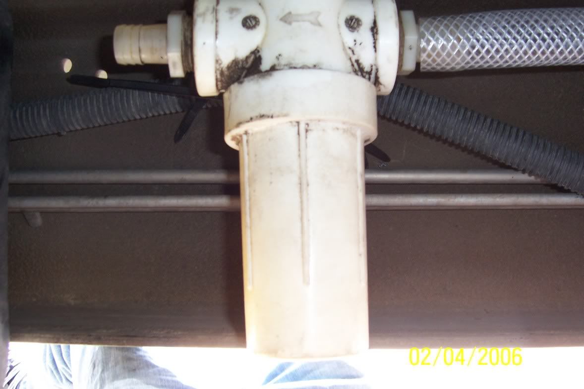

I did my CCV mod today. Thanks to lifted_up who sent me a piece of pipe.:thumbs I ran my tube to an old water filter that I got off of my pressure washer trailer. ( see pic below ) I still have to get a plug for the other end and another clamp. Do you think this will work, or do I need to just let it drip. I really don't know how much oil comes out of the CCV. I can just unscrew that round part hanging down and drain it every now and then. I saw on the TIKI that you can let it drain into the exaust but I don't weld and am not going to keep that exaust for long.

It will work, but you must remember to empty the filter every so often. I would start at a month from now and gage it from there. Good solution.
