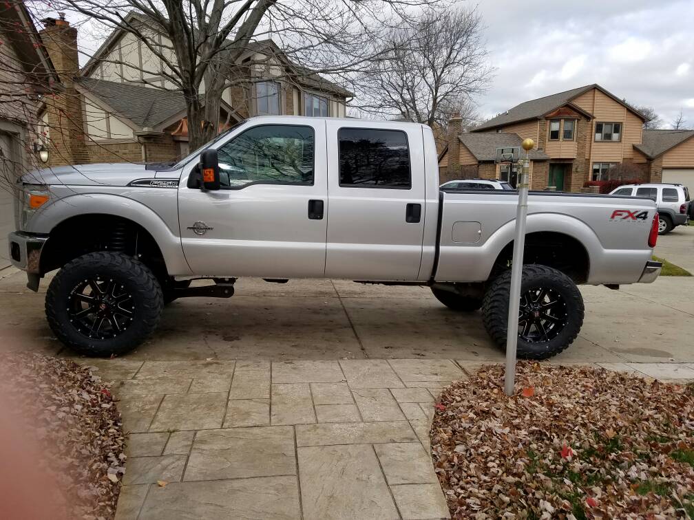

I have a 6" on my 2012 with 20x10 -19mm Ballistic Rages with 37x13.50's and they have no rub at full lock either way
