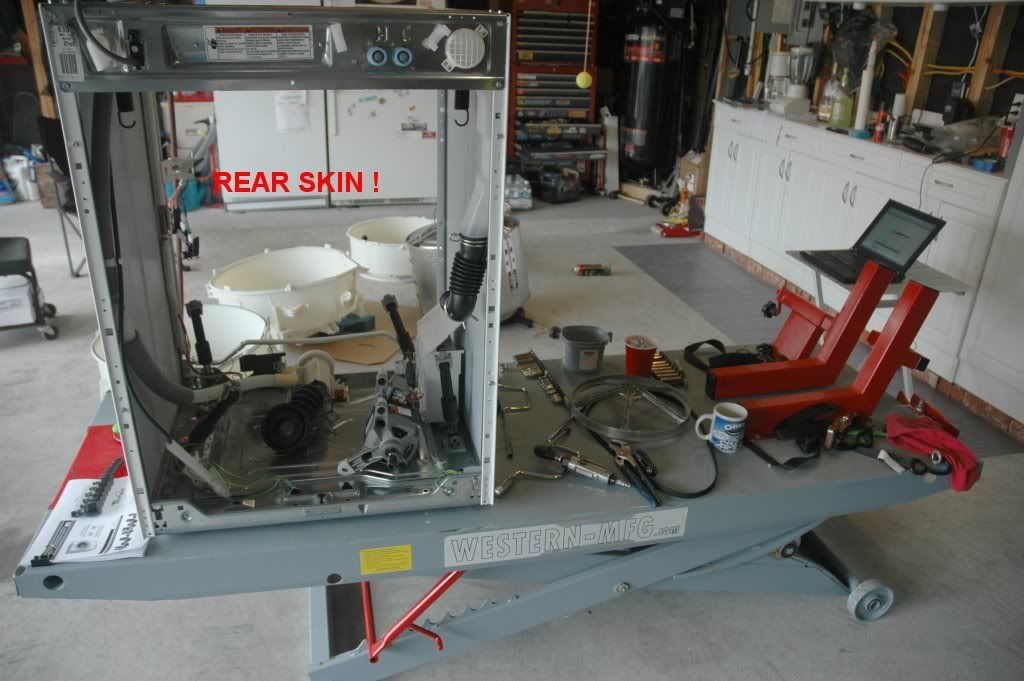

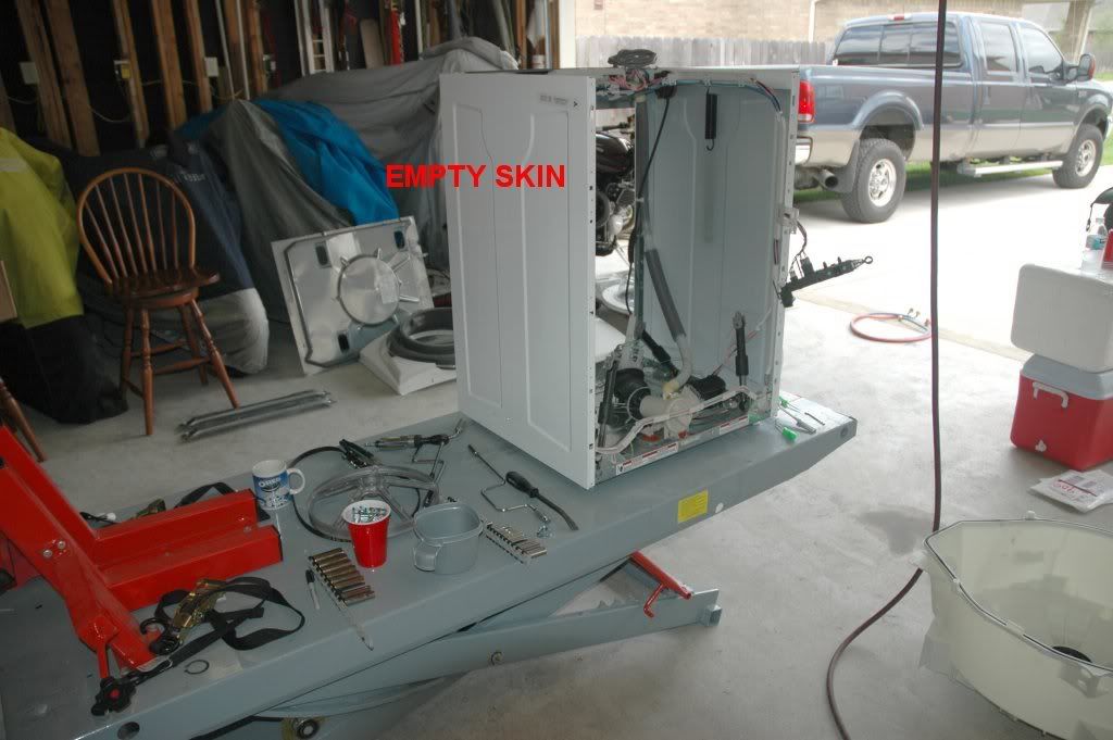

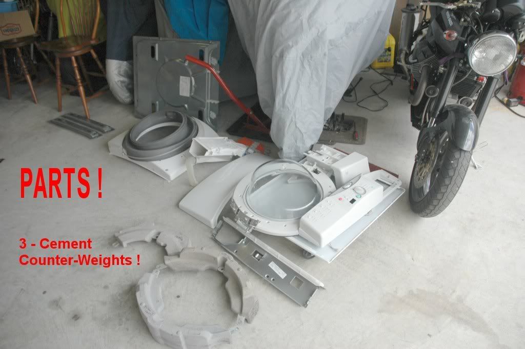

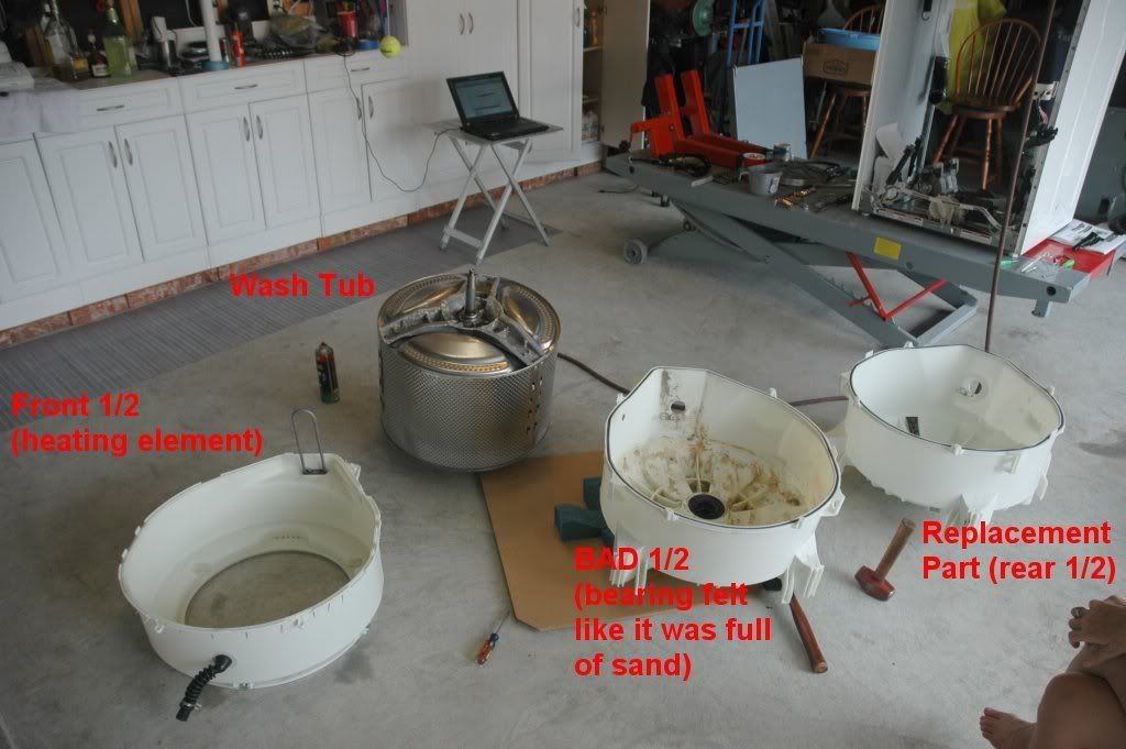

photos REPAIRED: Whirlpool <DUET> !
Good thing we have a 3 car garage...needed it for all the parts that have
to come off the washing machine so i could get to the part that needed replacement !
I could make a good living at fixing these things....rumor is that the repair
is over 600 bucks ! (i got the parts for 200 and felt LUCKY) !
thank GOD for Craftsman TOOLS !

same one...just finally got 'round tu-it !
I went slow...i was told it "paid" 4hrs...and the
professionals do it in 2-3hrs.
it took me 5 w/ testing and lunch...id do it again
in a heart beat...although i hope this bearing lasts
longer than 3 yrs !
