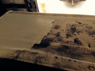

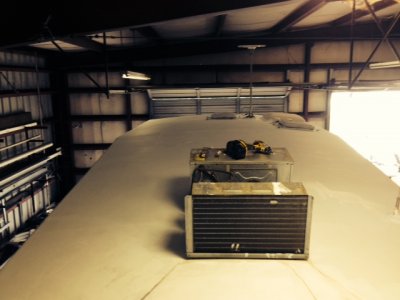

New roof piece I had to install on the front and the coating going on.
First coat of roof sealer on the hole camper.

Had a soft front roof so I pulled the roof loose and the rubber roof shrank and could not pull it back in place.
