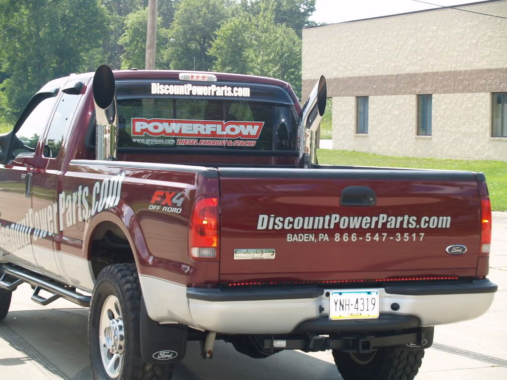

I'll post a picture of our 6" Aussies on a F-350. You'll get the idea of what a 36" stack would look like.
Thanks do you have a 6" mitre that exits just past the roof I looked at your web site and it only lists 5". I am worred the 36" tall will be to loud for my kids in the back seat a figured if thay where just passed the roof it would not be so bad. Also can I order direct from you at grand rock.

The 36" miters would be about the same height. Maybe a 1/2" taller. You can always add stack mufflers to help keep the sound down in the cab. You do have to order from a dealer though...sorry. You can call me here if you like, and I can give you part numbers, and Dealer contact numbers.
I've seen that truck before. That's Patrick's truck From DPP
I like the Aussies, but I aggree, they would look better if the bottom cut of the mitre came to the top of the roof line.
just buy the 48" and cut some off the bottom to make them the desired height you want.

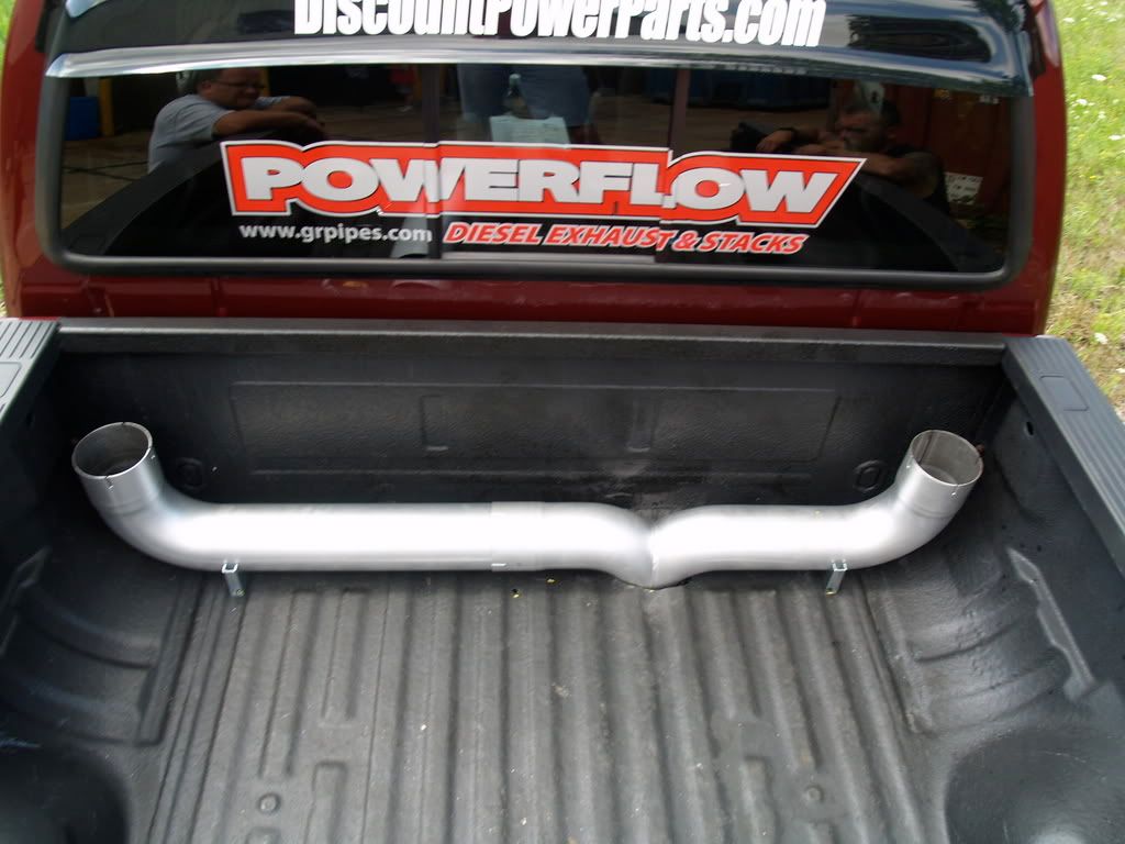

Since the Y-pipe sits on Saddle clamps in the bed...you could put spacers there to raise the y-pipe up 1-2 inches if needed. See attached picture, it shows how the y-pipe mounts to the bed.
