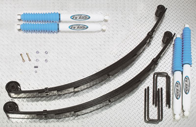

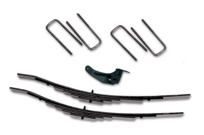

Well ive decided my '00 F-250 Need a little more height and a better ride. Ive been looking at all the offerings summit has. Summit makes a 2.5" kit that includes a six leaf pack to add to the existing front leaves. It also includes a track bar relocation bracket. The kit costs $239.95. Anyone install one of these? Will it make the truck ride even rougher? I have stock bumper and no winch and will not be plowing with it.
Ive also looked at a pro comp 2" lift kit. The kit includes a new 6 leaf front spring pack, 4 new shocks, and track bar relocation bracket. The pro comp kit is $440.95.
Im planning on installing either 33" or 35" tires in the future when i can afford them. I am just looking for a smoother ride on the street and less bottoming out in the dunes. Let me know if you have experience with either kit or other recommendations. Thanks

I cant lift the truck higher because it wont fit in the garage. With a 2" lift i will fit a little larger tire and keep it on a budget. I ordered the summit leveling kit. I also installed a new Rancho steering stabalizer that improved the ride. Any suggestions on shocks? I only want to spend about $160. Ill post some pictures when i get the lift on.

I tried a lift kit from 4 Wheel Parts (Pro Comp) and it sagged after a few years, so I got the Ford X code springs and replaced my 4 Wheel Parts kit. I am very happy with the results. Go with the X code springs and U bolts/nuts.

I have the Pro-Comp 2.5" leveling spring kit on my 2002 F250. It didn't change the ride on my truck. I put the F350 blocks on the back also.
I already had the Pro Comp 6 way adjustable shjocks and they worked with the lift.
