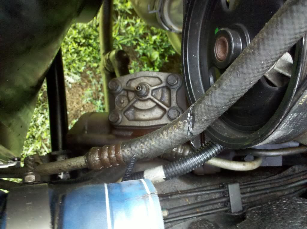

Ok so after my body work that I did from the deer accident, http://www.superdutydiesel.com/forums/911-diesel-down/27640-umm-help-body-parts.html, I decided to take a road trip to Pittsburgh to visit a friend with out even test driving my truck. Well only a few miles into PA and I noticed my steering and brakes become very tight. Well I drive about 300 miles like this and come to find out when I get to my buddies place that a power steering hose was cut from the power steering pulley and I lost all my fluid. My question is, what hose was it and could I have burned up my power steering pump for driving it for that long? Picture of the hose coming soon.

Well here is the hose.
It went from the cooler to the back of the pump. I was going to cut the line, put two barbed end fittings in it, hose clamp it and fill it back up with fluid, just so I can get home somewhat safely. Then replace the pump when I get home. I have 340 miles to drive tomorrow, I don't feel like battling the steering wheel on every turn and fear of rear ending anyone because I have to stand on the brake with two feet to stop. How will I know if the power steering pump is shot?
If it's in the same line as the cooler, then it's the low pressure return line. A hose barb connector fix should hold. I believe the pressure line is all metal tubing.
As far as knowing if the pump is damaged--:dunno:dunno
If it starts making noise, that would be an indicator.
FWIW, if you do have to replace it, make sure the pump pulley gets installed the same depth on the drive shaft as the original. Most pumps I've done, the pulleys are a press fit to the pump shaft. Measure the amount the shaft protrudes from the pulley and press it to then same amount on the new pump. That makes sure it is in alignment with all the other pulleys the serpintine belt rides on.
What TG sez ;tu
I don't like barb fitting/hose clamps though.. with hydraulics. JMO.
Might be a "Git It Home" fix however.

Thanks guys! Yeah I just repaired it, gonna go outside and try it out. Only problem is, I put in powersteering fluid instead of Mercon as recommended in the manual. Will this be a problem?
To be safe, I'd flush it out. You already have a hose barb in the line, that'd be a good place to drain the fluid from. Drain it, fill with ATF, run it, drain again and fill again with ATF.
You're already strectching your luck with the pump, IMHO I wouldn't push it.
