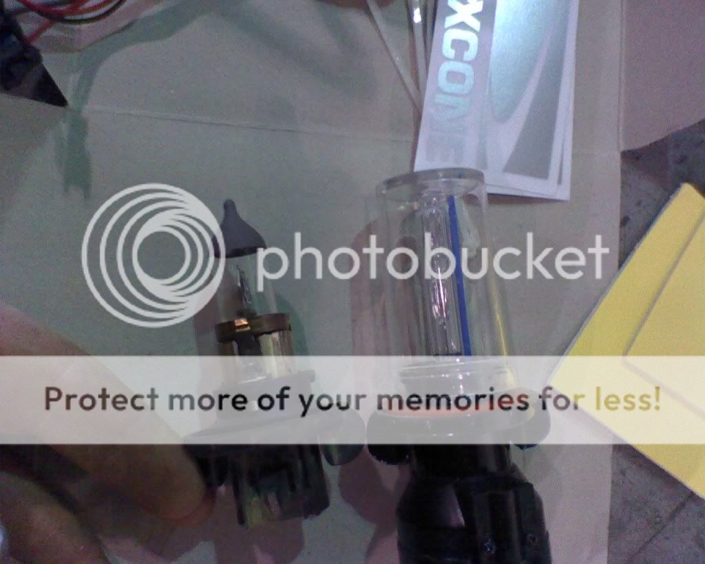

Here is a side by side comparison of the old and new bulbs, they are the same length but it is obvious that the elements are at different lengths than the OEM bulb. resons for differnet light difraction.

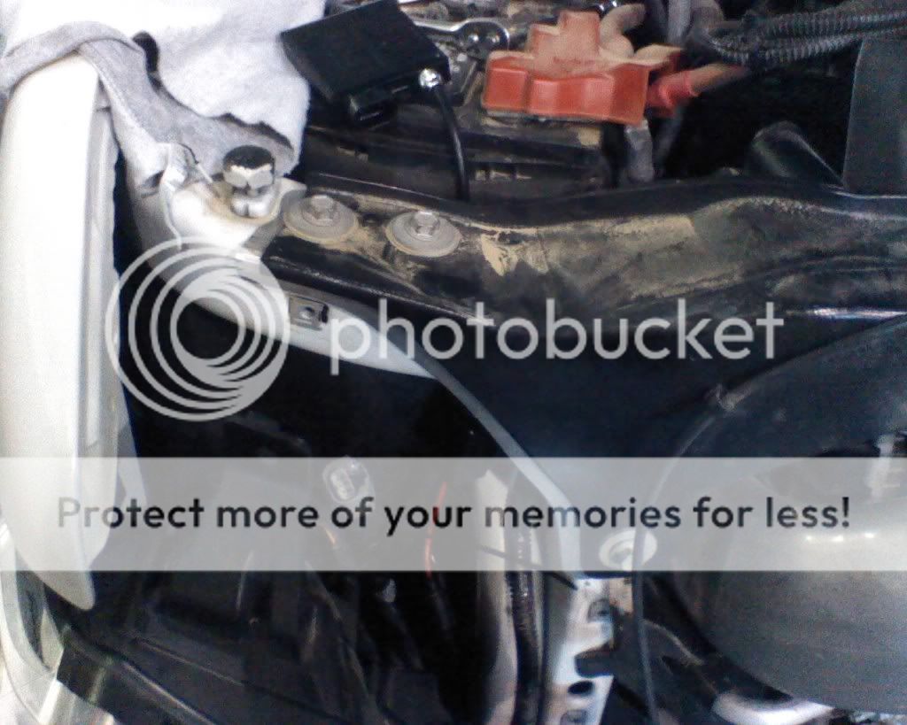

I decided to install the passenger side assy first, i ran wires to the ballast were i stuck it to the battery, the kit re-uses only one of the factory pigtails, so i bagged the passenger side pigtail and taped it up, see below.
here is a pic of the ballast installed on the passenger side battery

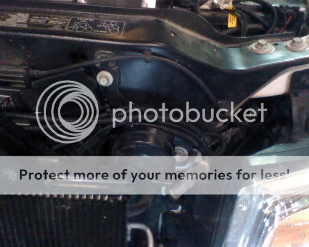

here is a pic of the routing of the wiring on the drivers side, nice and clean. :naughty:
here is the wiring and ballast placement on the driver side.
