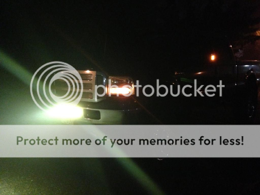

a 20" bar fits perfect in the bumper openings of 99-07 trucks replacing the factory foglights.
NICE Looks good :sweet:sweet
Yer right, Perfect fit..;tu;tu

Its a tighter fit on the 99-04 trucks and the light has to sit back a bit more in the bumper than the 05-07 trucks. For 05-07 its like it was meant to go there.

So do you have to do any extensive wiring for that?
If you mount them in the bumper opening you don't have to do extensive wiring. You can get a plug-and-play wiring harness along with the brackets and it will just plug into your OE fog light harness so you use the switch on the dash.

Any write up on the install of the 20inch in the bumper? I have mine mounted on top of the bumper but would love that clean look! If no write up maybe a quick how you did it. Thanks!! Great looking truck kjdavis!!
