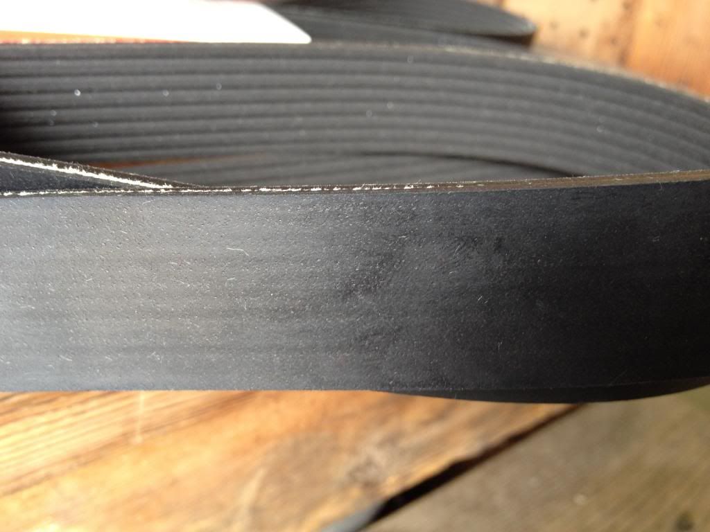

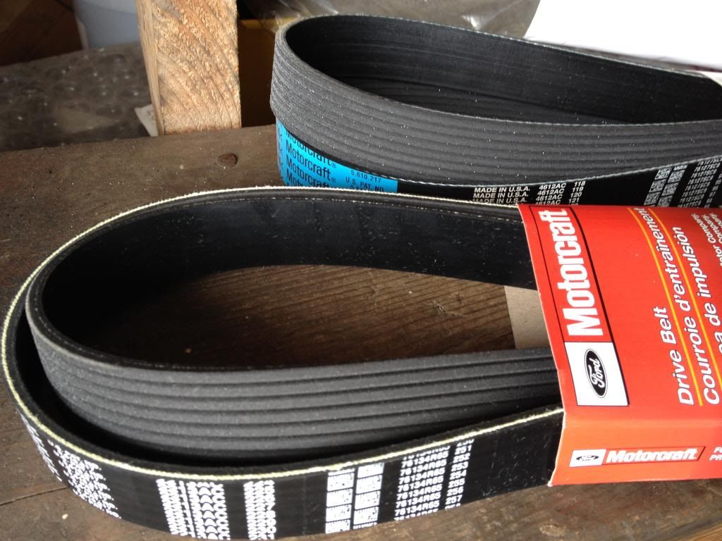

So I checked we had both versions of the belt and they look the same nothing special except the extra slippery backing. Oh and the new belt is only $37 now! Also in case you haven't heard Ford Motorcraft parts now come with a 24 month UNLIMITED MILES warranty. Here is the pics of the belts. Look the same to me...

Yeah I am sure there were quite a few out there that actually need the revised idler. Just never seen any it fixed.
