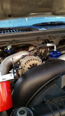

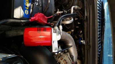

Bypass on the 6.0 is a GREAT idea.
Anything that keeps the oil cleaner is good for the injectors.
Super simple on the 6.0 as well. A tap off the filter cap, a return to the oil filler tube through the cap.
Frantz is very good, but the cartridges are a bit on the pricy side.
Frantz is now part of the HotShots family.
Now, you can get a used Frantz from eBay, and refurb it with new parts. They have not changed the basic design in 50 years. The older units were made by Sky.
The new clamp fits in place of the original spring load, and a modern day roll of Scotts 1000 can be fitted if the center tube is sleeved with a high temp heat shrink. Some paper must be unwound from the roll until it's a snug fit in the can. Back in the day John Wayne TP (won't take crap off anyone) had a 1.5 inch core, modern TP has a larger core (less product, but you don't realize it) so sleeving the center tube works just fine.
There are other ways. A Baldwin head and NAPA 1050 or Baldwin B50 bypass filter works almost as well, not quite the filtering ability of a Frantz, but better than no bypass at all.
That's what I did on my 6.0. Total cost was less than 150.
Change oil and filter every 5k, bypass filter every 10k. They only get more efficient as time goes on.
