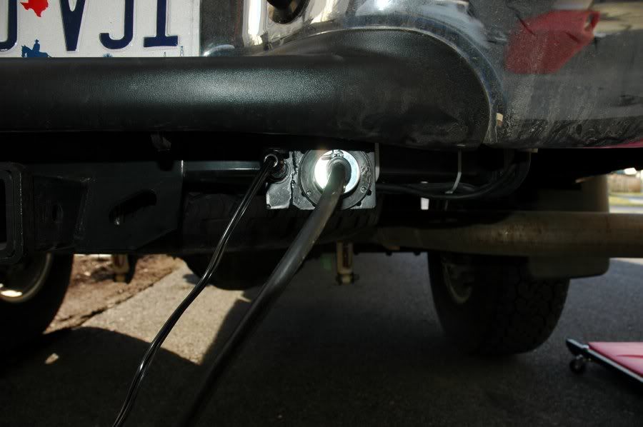

I also "moved" my heater outlet to the rear of the truck...made my own
HEAVY extension cord & attached it to the underside of the truck/frame
and installed a marinco outlet under the rear bumper.
I back my truck into the drive way...and the outlet is basically right
there, against the garage door...no cords running down my driveway
and since the cord pulls STRAIGHT out...its no big deal if i forget to
disconnect the cord when i pull out of the driveway.
MFG P/N & LINK: INTERMATIC DT17C TIMER
MARINCO (mfg partnumber) 150BBI Outlet -->
you can see MORE detailed images of the rear mounted outlet HERE
the 2nd cord you see in the photo is a 12v battery maint. outlet.

i know theres a write up for this some where but...
i made my own "extension" cord...i did NOT cut the
factory plug @ the front of the truck...I applied liberal
amounts of dilectric grease, plugged things together and
taped the HELL outta it (to keep the elements out).
I ran the "home made" cord down the frame, tied it
w/ zip ties and installed the marinco outlet @ the back.
i typically back my truck in where ever possible but i didnt
want to be in a situation where i might ONE DAY need
the connection @ the front (so i left the factory cord in place).
