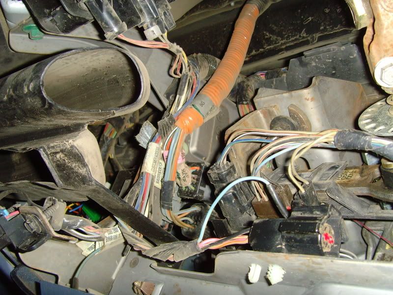

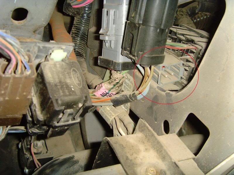

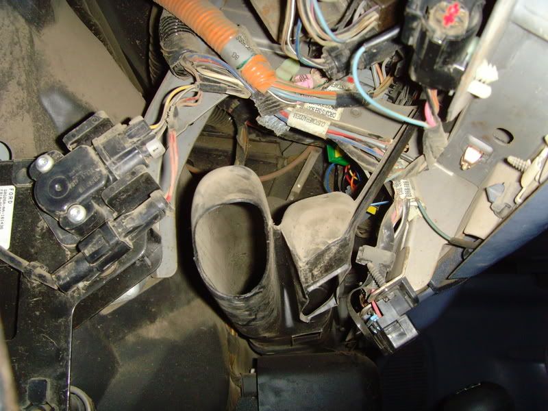

Here are a couple pics of what I've got.
Thanks!

Trailer tow was an option for 99 and 00 years XL and XLT models. Option on 01 and up XL models.
I don't see the connector in your photos.

You are absolutely correct! If you still have the harness in your glove box, all the trucks came with the harness that plugs directly into that port. ;tu

After everything is wired up you may want to check your under hood fuse box. After pluging my harness in and getting my box hooked up I had no power to the box. I needed to add a couple of fuses in order for everything to work correctly. I don't remember the numbers but they will be listed in your owners manual.
You know Ford sure made the brake box plug hard to get at. If they had put it on the drivers side if that brace it would a lot easier to access.

"You know Ford sure made the brake box plug hard to get at. If they had put it on the drivers side if that brace it would a lot easier to access."
That's for sure, not the best planning.
