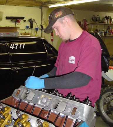

Well I just joined today! You can count on my being on this forum checking things out almost everyday and putting my 2cents in here and there. I have been looking for a good forum like this for who knows how long now. This place is great and I already got some great ideas for mods! Infact, I am very experienced in building my race motors. My current motor my 427 has 725HP (at the fly wheel) here is a pic of me working on it
725 HP--is that all? You know, if you add a bunch of stickers and a fart-cannon exhaust tip, that HAS to add at least 150 HP (10 per sticker and 100 for the tip)... ;) :p :p
You also need to add one of THESE to your car "IF YOU WANT TO MAKE YOUR CAR SOUND FASTER AND MORE AGRESSIVE BY ADDING A NICE HIGH-PITCH "SPOOLING" TONE:...
