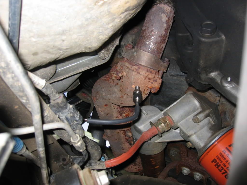

To install the EGT probe we put it in at the bottom of the drivers side exhaust manifold (Pre Turbo) Fire1 is the local specialist with EGT installs:sweet

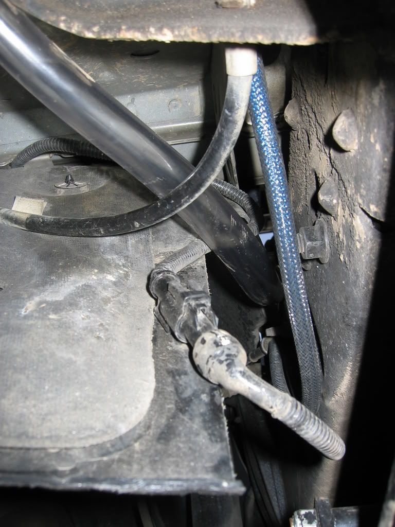

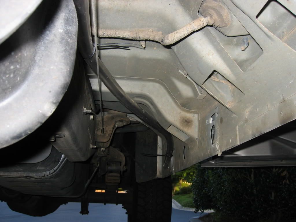

did the CCV reroute with parts from home depot. 10' of 3/4" ID tube, a hose barb, and 3" to 3" pvc coupling (4" OD). ran the hose down the frame rail to about the back of the cab on the driver's side.

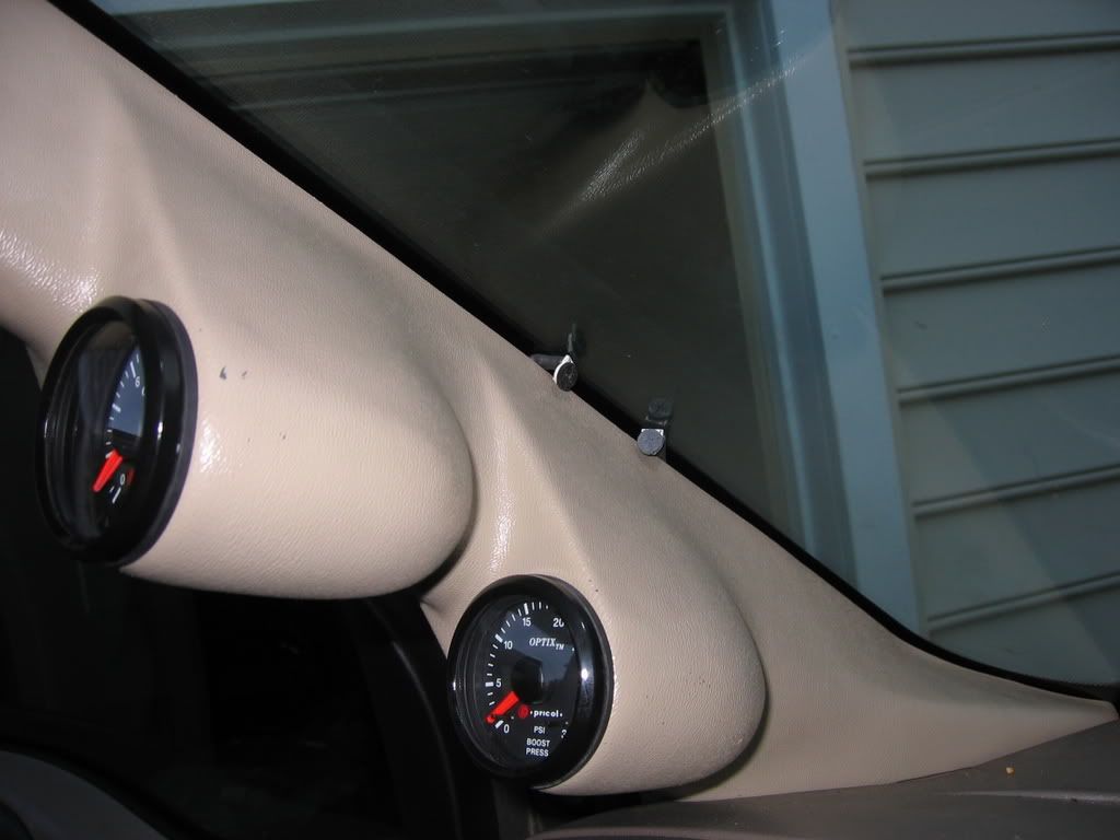

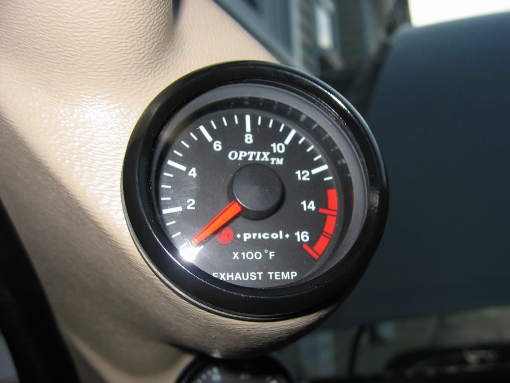

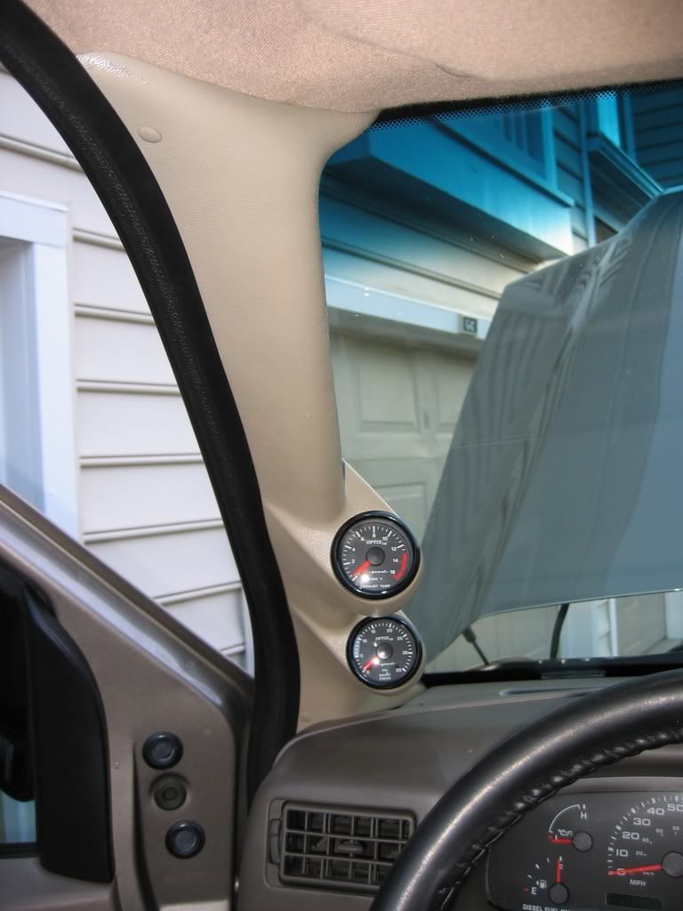

Well, i finished installing my dipricol gauges and pillar pod today. took about 3 hours, moving slow. drilled, tapped, and installed the pyro, ran the wires through the firewall. I used the cheater dipricol harness with the dimmers already built in.

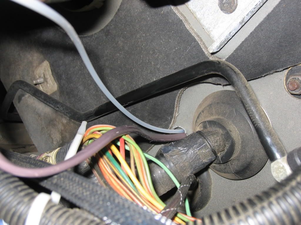

through the firewall (drilled my own hole, put a grommet in after pic
pyro:

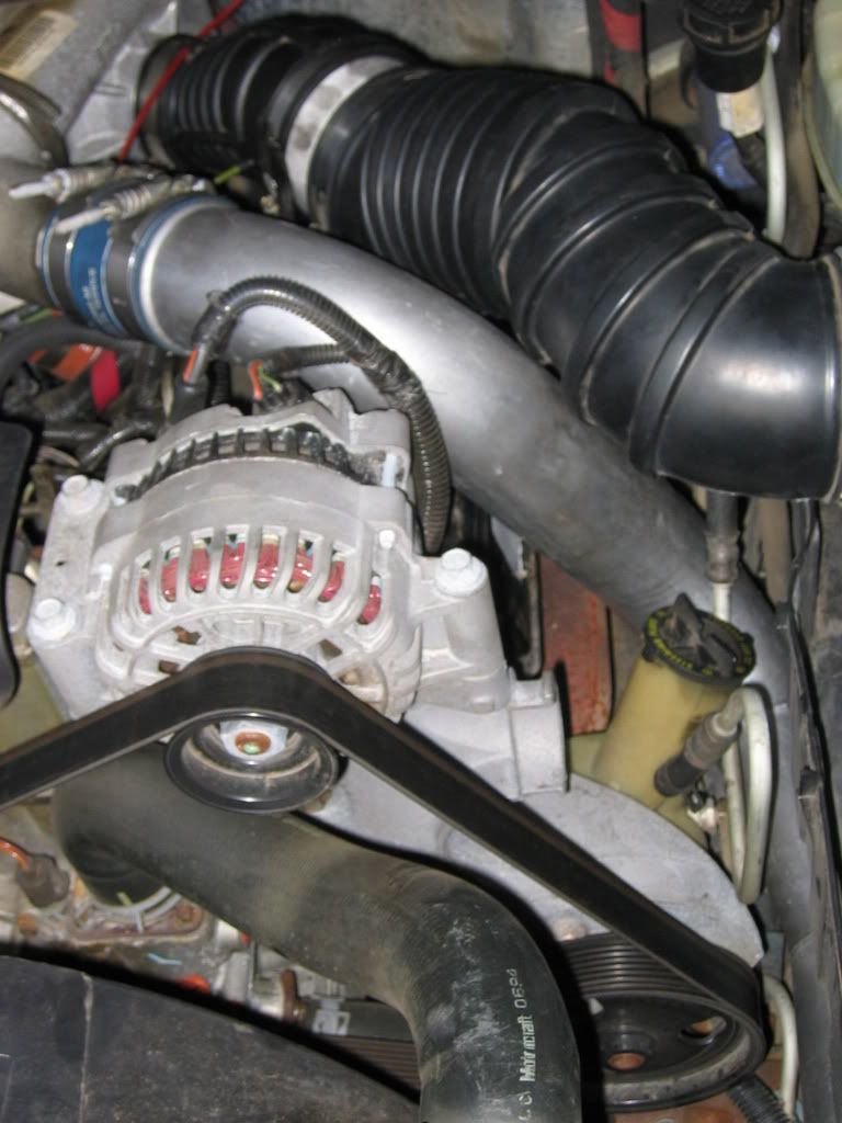

the defoiled pipe:

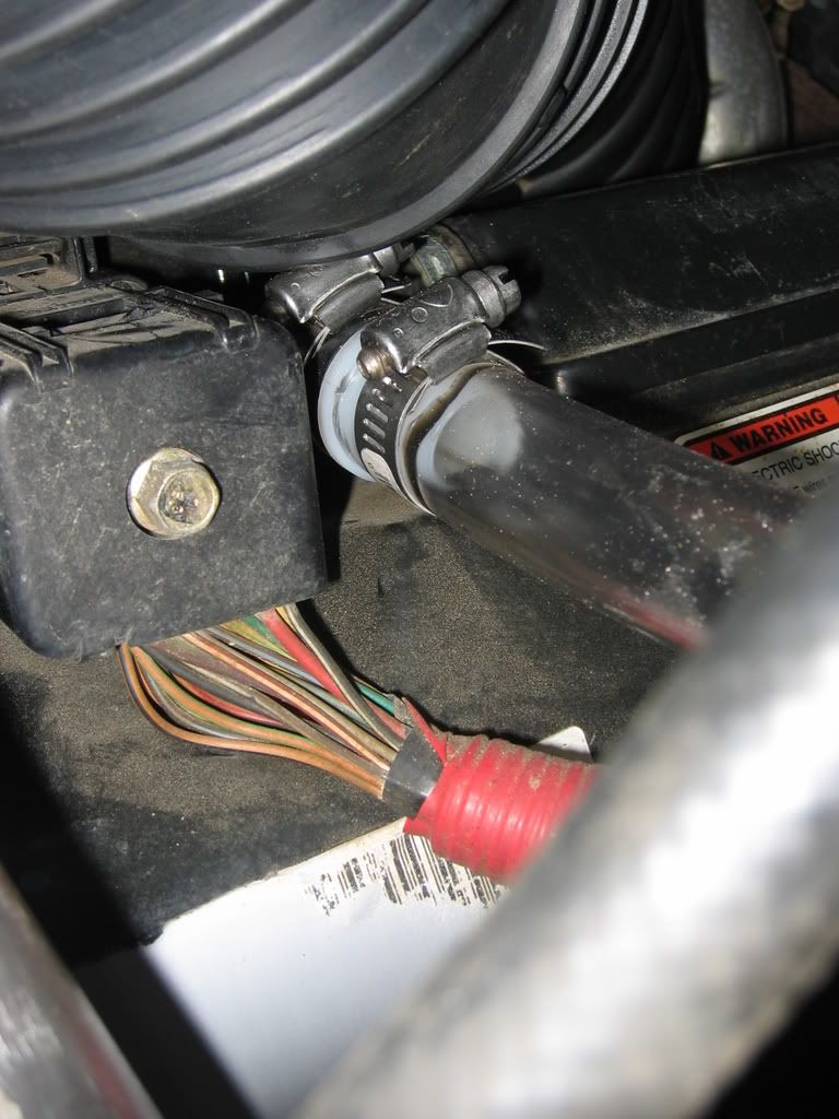

ccv:
the boost gauge isnt hooked up yet pending arrival of or pdp/post office finding my aih plug/boost fitting. i'll get some nighttime pics of the gauges at some point. I bought the F5 today, got nostart/stock/hiidle/40/80/120/140agg w/ lope

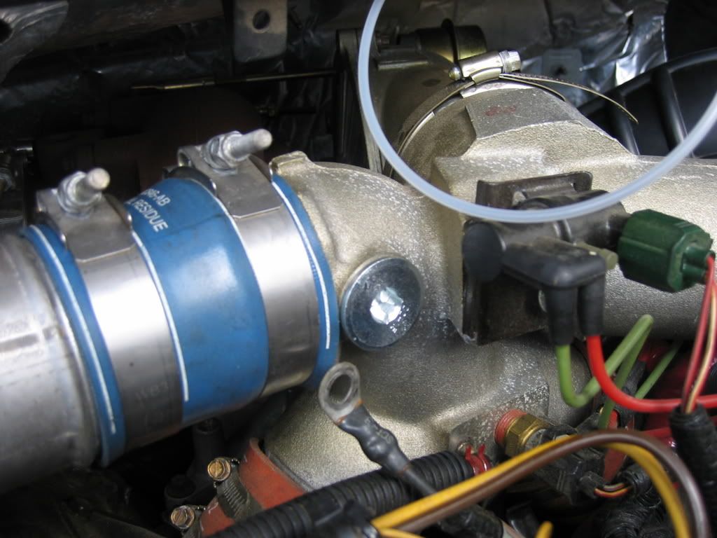

welp, i got my aih delete finished up last night. The postal suckvice lost my package with the plug and code elim, so i decided i'd just make my own plug. I read so many posts of people with the code eliminator that said they still had the code that i gave up on that too. I'll probably just return the stuff if it ever shows, and if it doesn't i talked it over with the vendor and we'll pursue the insurance on the package.
soo...

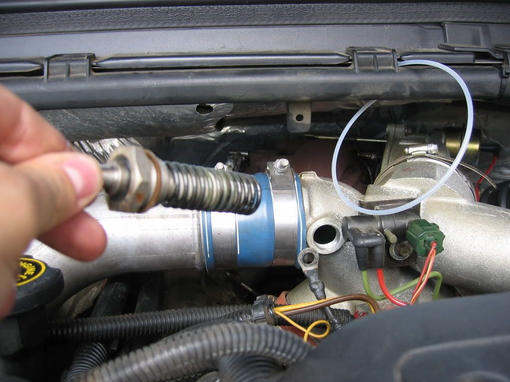

step 1. remove the hot and ground wire from the existing air intake heater (AIH), and remove the AIH from the intake pipe. I just used channel locks since i didn't have an eleventygabillion mm socket around. Follow the hot wire back to the solenoid, and remove ONLY that wire from that terminal on the solenoid. Be careful when you take the nut off of the post, as there is a washer that will commit suicide into your intake valley. Mine will now live permanently under my hpop. :shrug: Follow the ground back to its mounting point on the block and back that nut off and remove the wire. On mine the whole stud came out of the block, so i had to separate the nut and stud off the truck and then reinstall it. no biggie.
in this pic you can see the ground wire just near the AIH location.

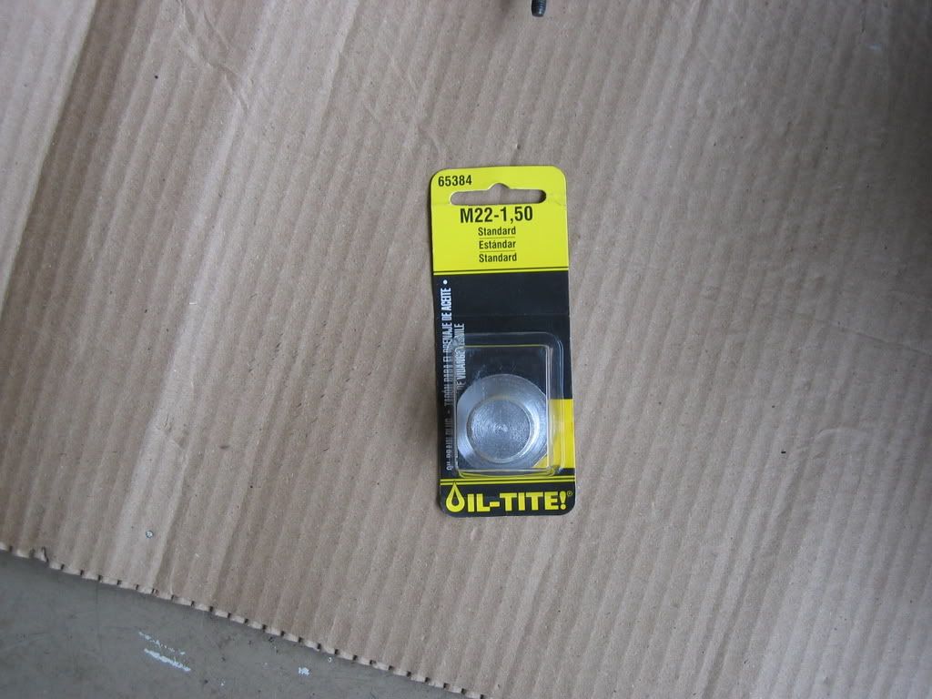

next, take your 94-01 ram diesel drain plug (just 22mm x 1.5 plug, has a 3/8" square drive....you could probably use anything with 22mmx1.5)

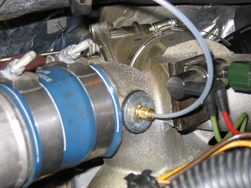

and screw it into the AIH location. If this is all you're doing, you're done here.
i wanted mine to double as a boost fitting though, so i drilled the center of the plug out to 21/64 or whatever the 1/8" NPT tap's required drill bit was. because of the design of the plug, the 3/8" square drive is a little bigger than the hole you drilled, so there is no meat to tap at the top of the plug. i grabbed my uni-bit (greatest single tool of all time, ever, period, end of discussion...) and hogged out the top of the hole to about 1/2" which then let me tap the 21/64" hole a little further down. because of this the brass fitting when tight sat almost flush with the surface of the plug itself. Just for overkill i filled in inbetween the brass fitting and plug with epoxy.
I threw it into the intake with the supplied rubber coated metal washer that came with the plug, and tightened her up with my channel locks again, since the plug is round and the tapping eliminated the 3/8" square drive hole. then i just ran the air line and tightened her up.

Also, to avoid the issue with the 3/8" square being bigger than the drilled hole for a 1/8" NPT, it would be easier to use a 1/4" NPT drillbit and tap and use a 1/8" to 3/8" NPT adapter for the brass fitting. This fitting was included with my dipricol boost gauge, but my local ace hardware was out of stock on their 1/4" NPT taps and home depot doesn't sell npt taps at all. I was getting friggin impatient so i made this work.

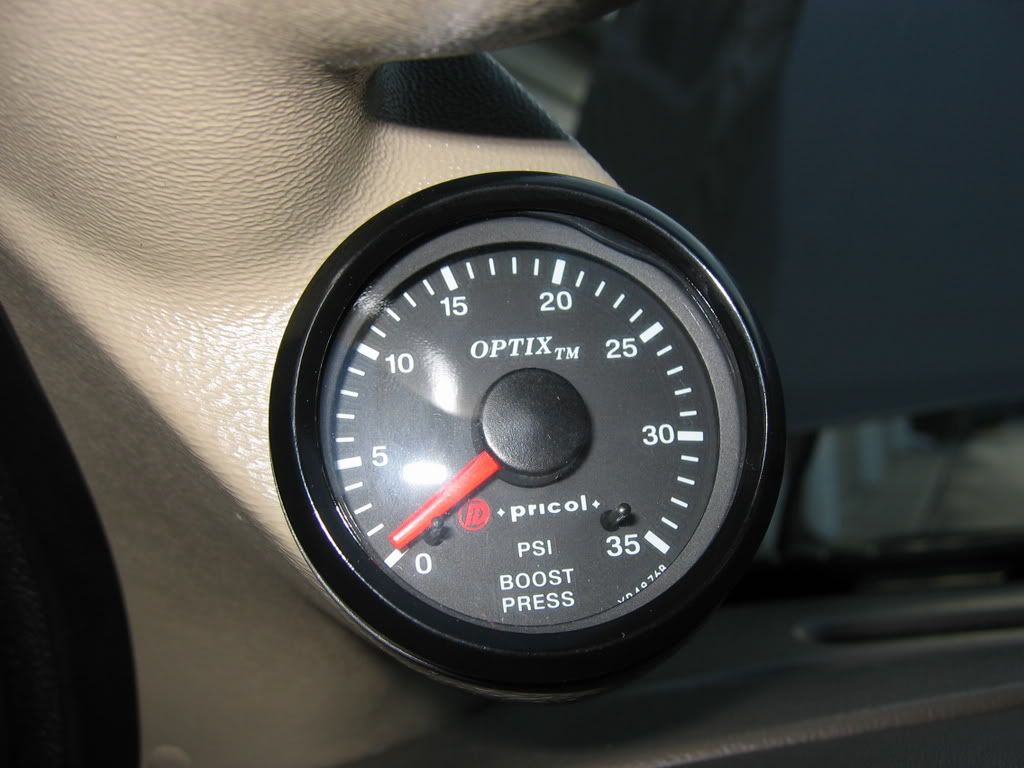

So....the boost gauge works. On the test drive(s) on the interstate uphill with the pedal on the floor the boost climbs quick to about 12 psi, and then continues up to about 18-19, and stops there. Is this correct? I was expecting a little higher maybe 22ish.
