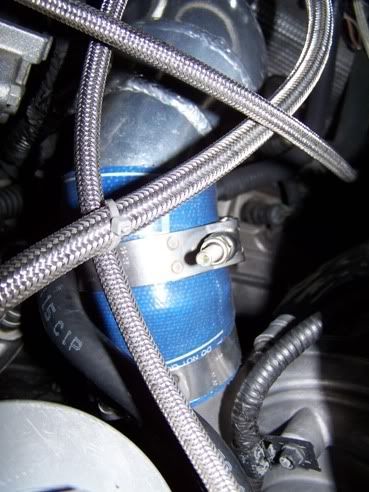

Hey Knick,
if you are talking about the boot from the turbo to the hot side boost tube AND if you have the retro fit boost tube (newer one), I took off the banks boot and re-used the OEM ford boot from the stock system.
it was a pill to put on, but it aint going nowhere now. the newer banks retro fit boot is way to short and is way too slick to stay on.

Hey Knick,
just an idea.
Thanks Bama!
I agree the Banks one is way too short, and very slippery.
I'll look around and hopefully I still have the stock one, if so, I'll give it a shot.:thanks

I went out and took some pics right quick. finally got the pics to download :rant
