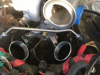

Riffraff makes a great stainless unit with perfect bends to clear pedestal. Install on my 2002.
