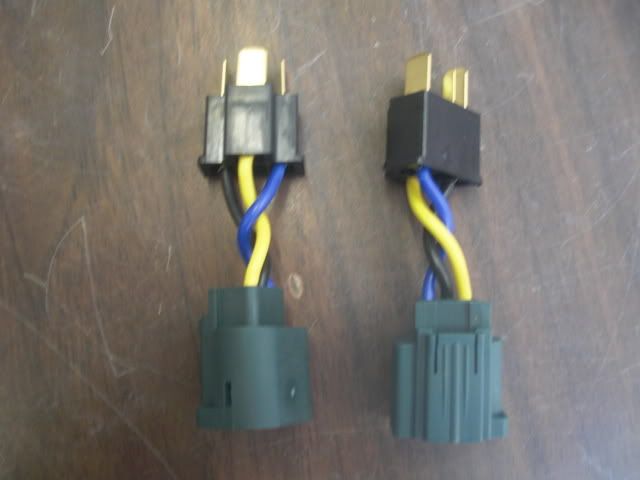

WRITEUP:
The conversion is pretty much plug and play
-ALL mounting points are the same
-ALL bulbs except <MAIN HEADLIGHTS> are the same and plugs into each corresponding socket
-Main Headlights can be rewired or use DFuser.com conversion harness
-Harley Davidson Lights even come with bulbs

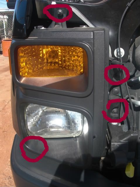

Here's some pics:
Old ugly worktruck headlight assembly, circles point out mounting points....BOOO!
Nice new Harley Davidson assembly...Yay!
Mounting point comparisons: <4points=1 on top, 2 on the insides and 1 on the bottom>
BOTTOM:
RIGHT SIDE:
TOP:
All the same no DRILING, HAMMERING, CUTTING!!!!
Headlight Conversion Harness...thanks Bill @DFuser.com
Black Sealed Beam>Green H13 Aero Lights...if you can't figure it out you deserve to run the work truck lights....JK!
Bulbs plug right in:

I just compared the work truck lights to a pic of the aero ones. The entire work truck assembly is a one piece frame just like the aero, so I'm assuming both the mounting points are the same. Re-wiring shouldn't be too bad...
