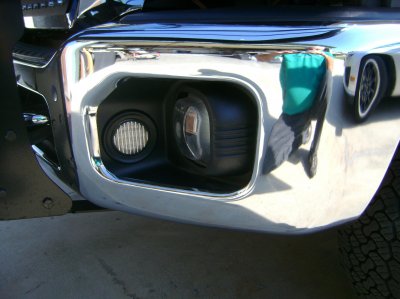

Ditch Lights ?
Wanted some light directly to the front sides, so I conjured up this idea.
Found these 2 1/2" LED's on Amazon.. Cut a 3" hole for the rubber mounting grommets.. wired them into the Light Bar circuit.
They're a back-up light, so they are a flood pattern. Works Great.

These shine slightly forward but light the area between where the headlight pattern hits.. and the front corners. Oh wait, that's for a Ford Pick-up :)

did you wire them to come on for a period of time with the turn signals at night??
Nope.. they're just wired up with the Light Bar on the grill guard (for now). Lots'a remote country roads and highways around here Robert.. nice to have everything lit up.. out front.. was what I was after. Does a Real Nice job of that.

Joe this looks like an awesome idea! Remind me again, what kind of light bar are you running?

It's a 30", 90 watt made by CREE. Mounted on a Rhino Grille/Brush guard.
