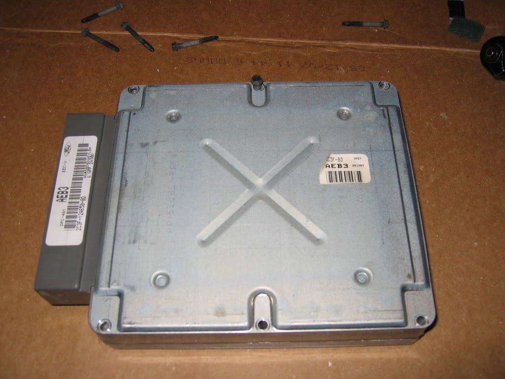

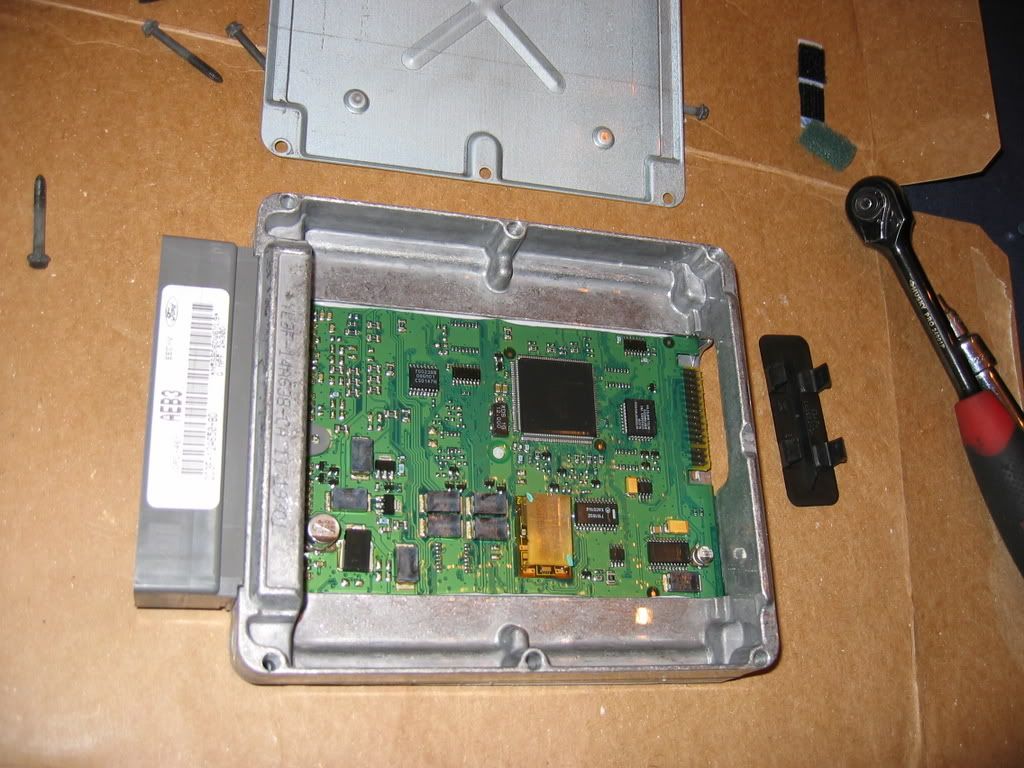

Loosen the 10mm bolt in the PCM connector on the firewall side, and remove the connector. Inside the truck (since I have a giant clutch pedal in the way) the instructions point out it is easier to remove the PCM from the truck by removing the entire metal bracket it mounts to. This consists of removing the two 10mm bolts that hold it on.
Remove the PCM from the plastic sleeve. Then remove the bolts on the PCM cover:

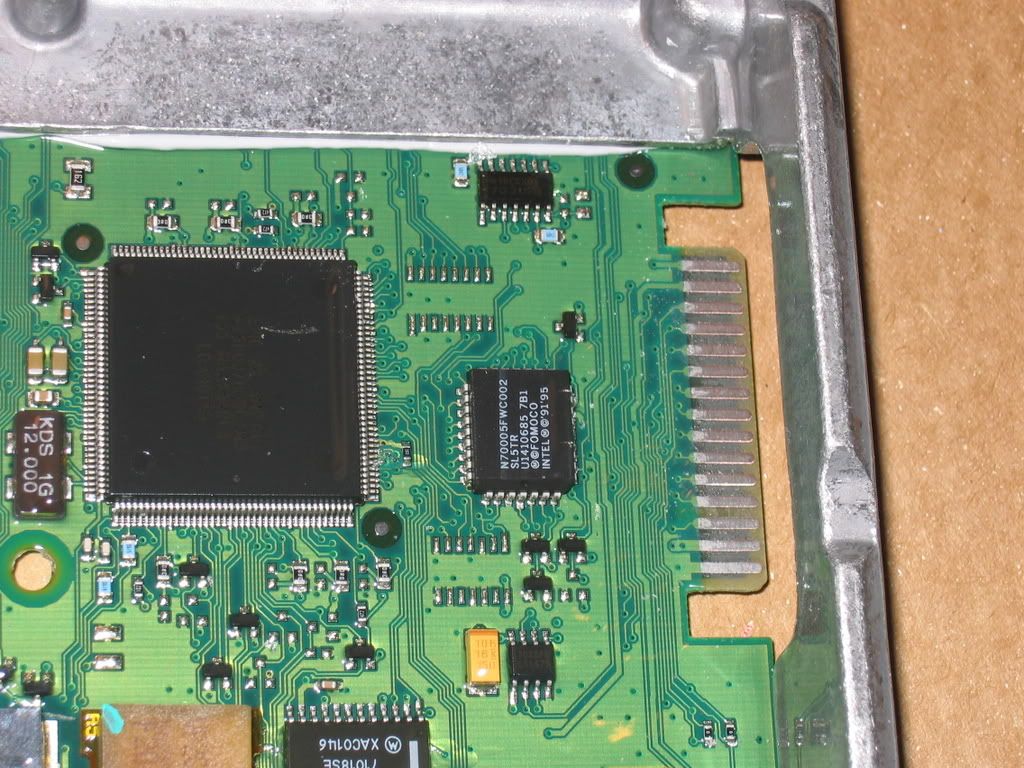

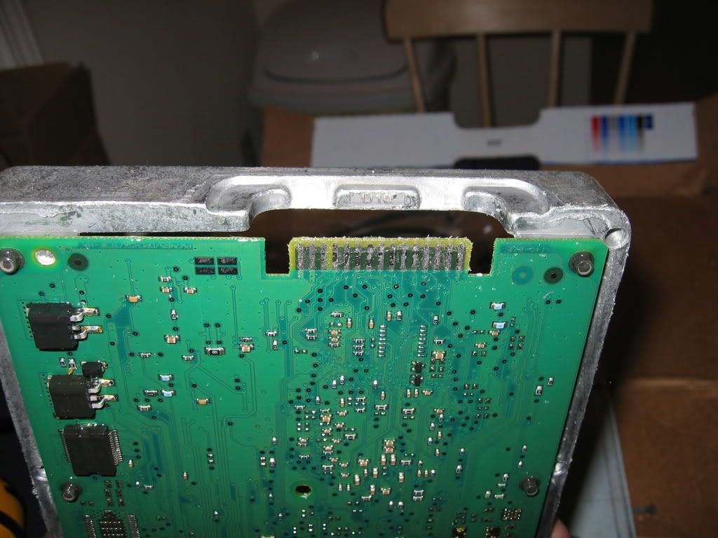

Pop out the black plastic cover, and get started on removing the board coating over the contacts. This was actually a lot more involved than I inspected, no wonder this is a source of problems with the final operation for some people. As per the instructions, scrape it off, then take the scotchbrite to it. Eventually you will have clean brushed tin. Some copper will begin to show through.
in progress:
ready to rock:

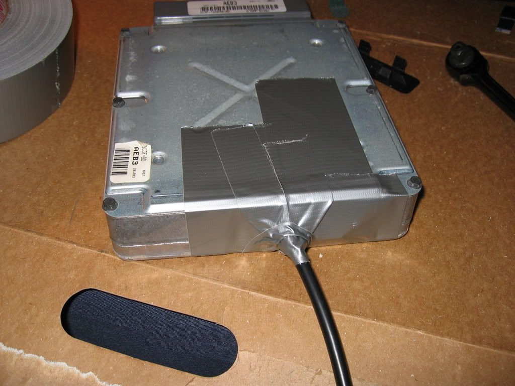

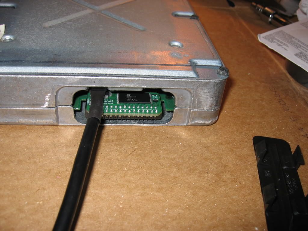

Next...plug the cable into the chip, and the chip onto the PCM board and reassemble the case.
Then the instructions tell you to use cloth tape to hold the chip in place.

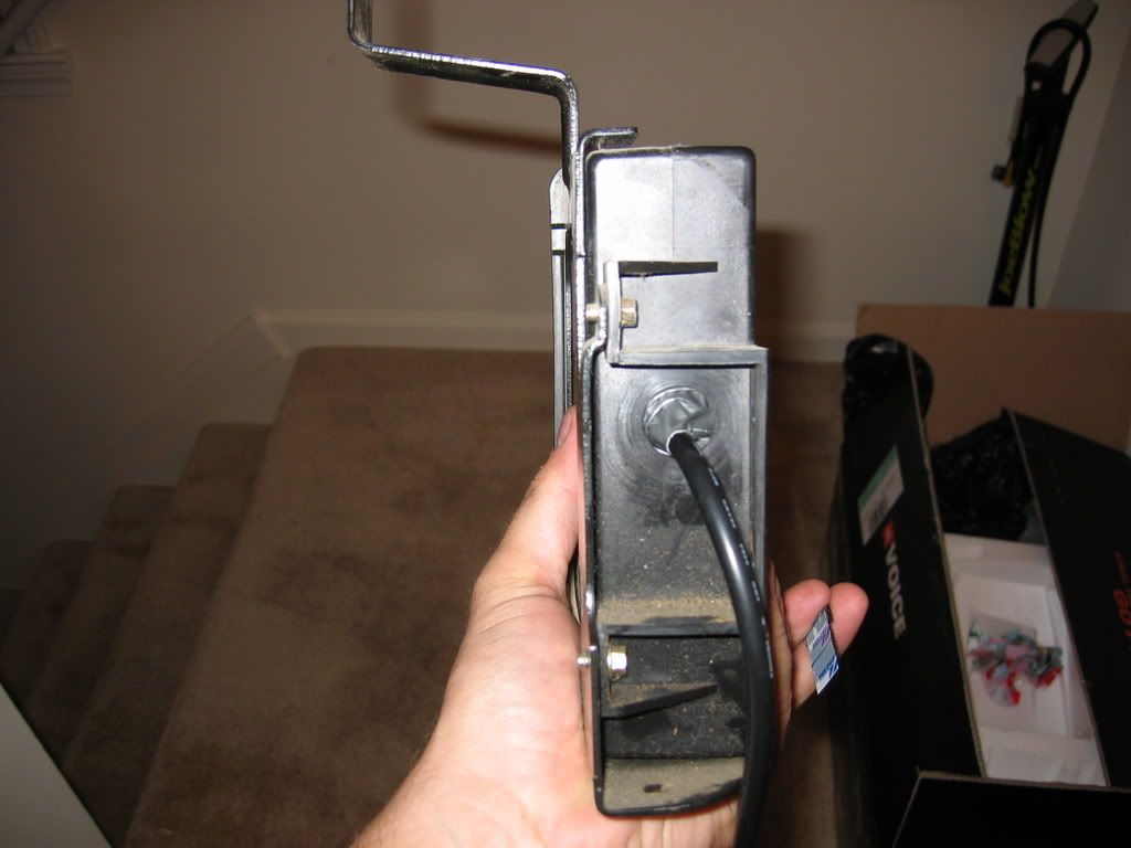

I opted to drill a hole into the plastic case to run the switch wire.

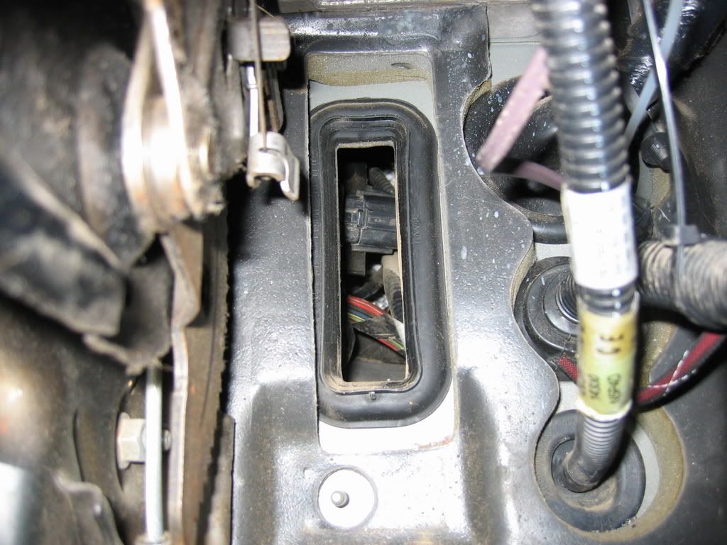

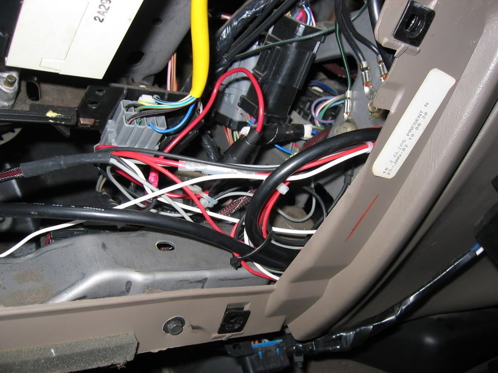

Here is a just because picture of the PCM hole through the firewall.

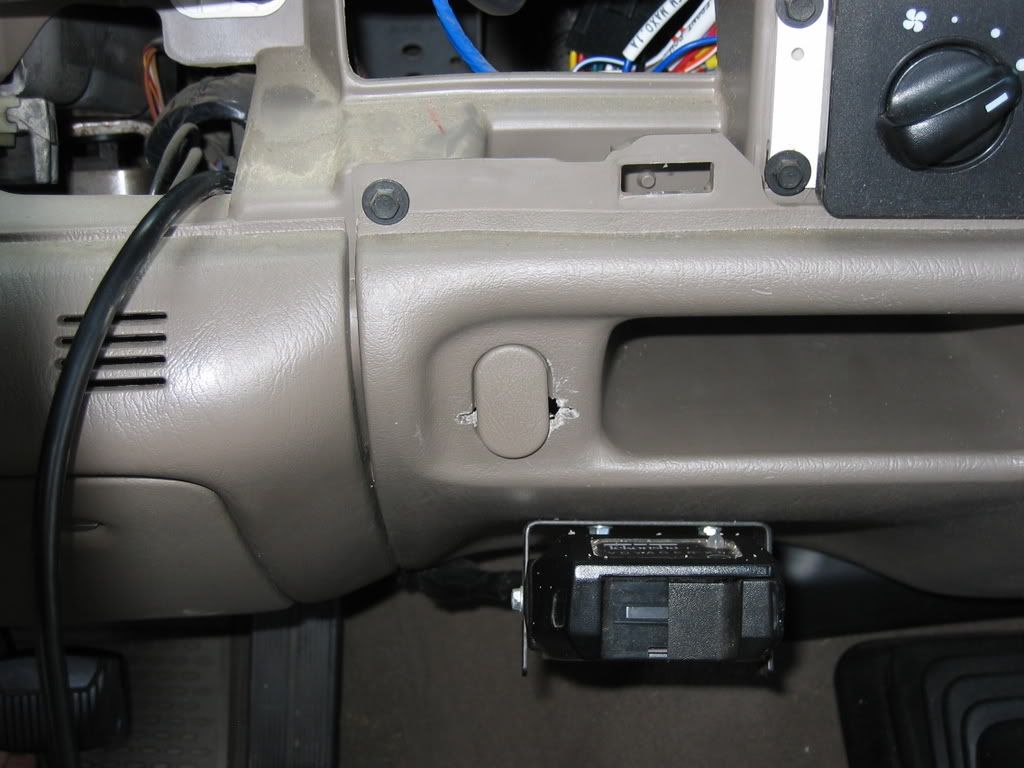

I originally mounted the switch in the location the instructions suggest, but quickly found I considered it unacceptable for a few reasons. More on that later.

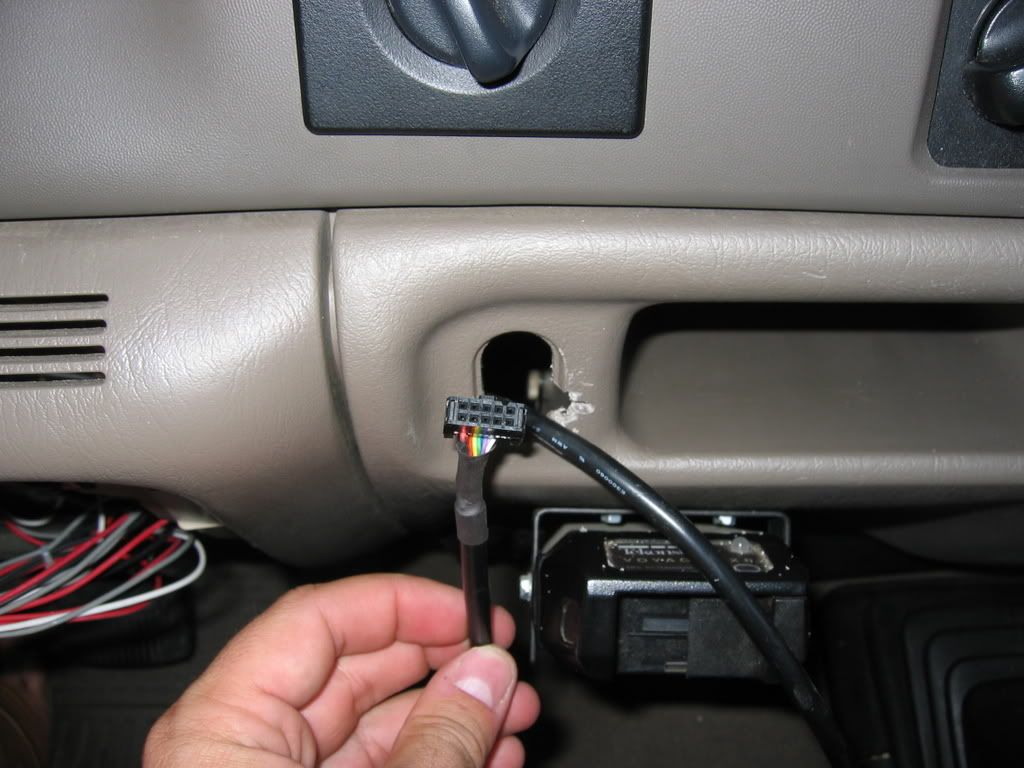

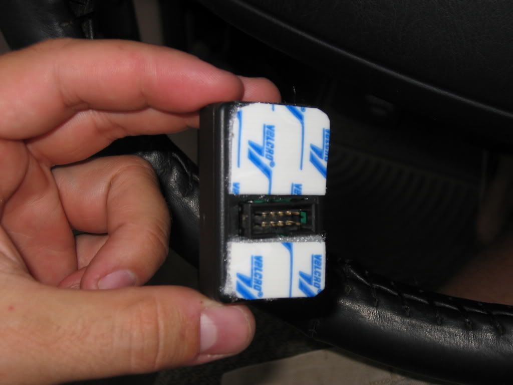

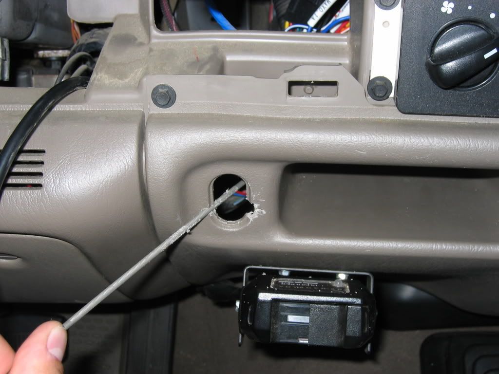

I then decided to mount my switch in the factory location for the adjustable pedal switch ( i think? ). I popped the cover out and started to trim the hole to fit the cable connector on the backside of the switch. I also cut to slits on the side of the hole to make room for my ziptie...more on this later too. I mounted it to the panel with a larger piece of industrial strength velcro.

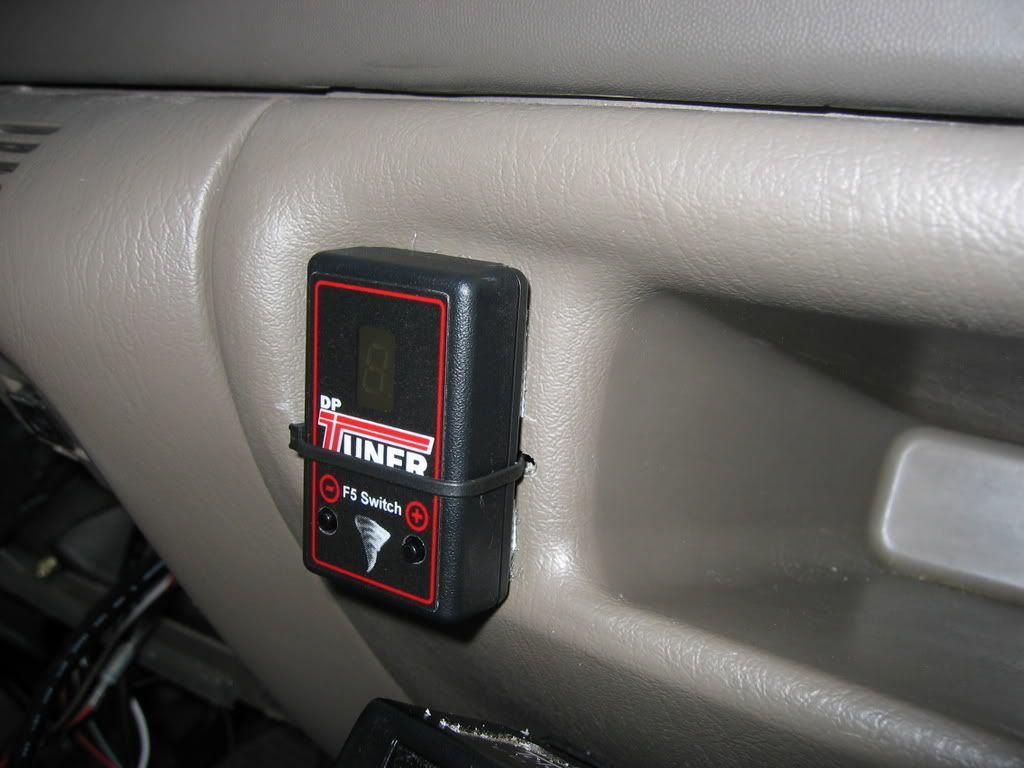

The reason I chose a new location was because the suggested location isn't (wasn't for me anyway) visible from the driver's seat while driving in a straight line. Since this is 99.9999% what is going to be going on, I figured this location would work better for me. This next pic is shatty quality, but the point of it is to show the suggested location is hidden by the wheel and this location isn't.

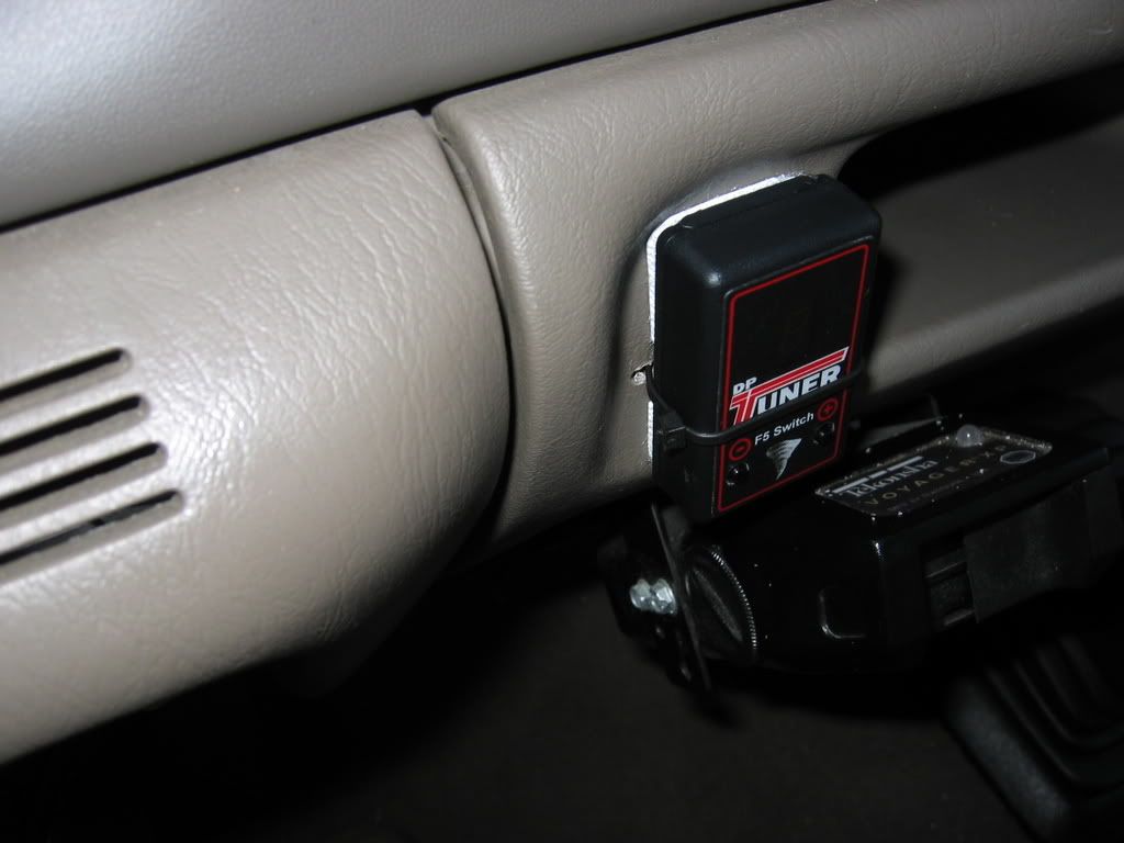

pic of the wire tucked away and ziptied in with the rest of my gauge harness excess:

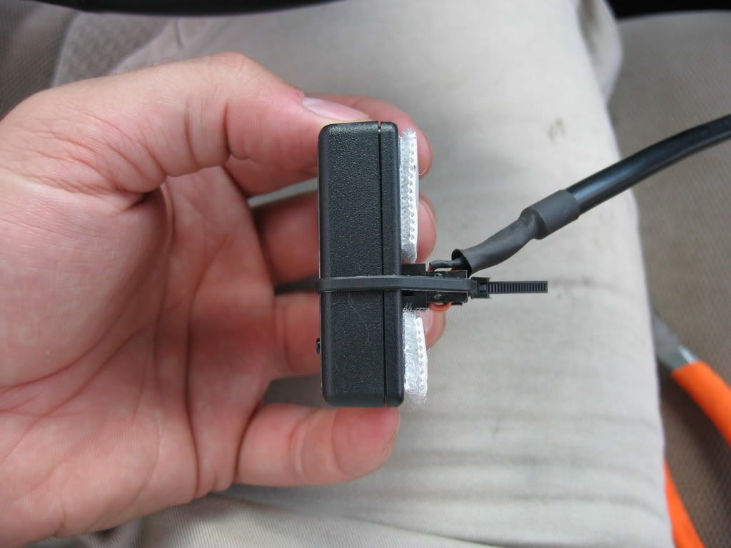

Being an engineer, I am all about the fit and finish and attention to detail of products. I do not like the fact that the recommended way to hold the chip into the PCM is 'cloth tape.' That just does not sound like a solution to a product I want to use for another 200,000 miles. I think the cable ends and receptacles on the chip and switch need to have locking tabs or some kind of locking feature. Given the fact that my switch becoming dislodged will turn my ENGINE off, I would almost even prefer a bolted connection like the factory PCM connection. I just do not have confidence in the connection between the cable and chip and cable and switch; its not a tight fit at all. This is why I have a ziptie around my switch. I'm already having an intermittent inop issue with the chip coming from the cable/switch interface, and I've had it installed for about 24 hours. That is why I put the zip tie on there, and I still had to do a little jiggling to get it function. However, given my previous experience with Jody and Diane, I am sure they will offer fast assistance to get this cleared up. The switch itself is kind of cheesy feeling, but it works and that's what matters.
